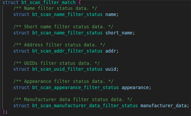

    2. How to easily retrieve the device name from the reflector correctly and to see where it is stored (because the bt_scan_filter_match contains some usefull info that i dont know how i can use)

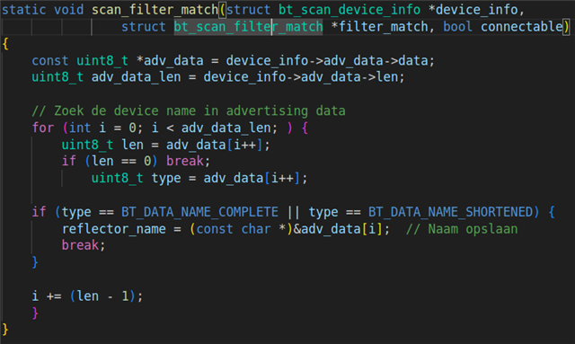

    to retrieve the reflectors name i currently use:
    but this code also has random characters behind the name

    2. The device name can be added to the advertisement packet with BT_DATA_NAME_COMPLETE. Please check out the DevAcademy course on Bluetooth Low Energy available here.
    3. Yes, it should be able to filter for specific devices, either with device name or by UUID filterting.
