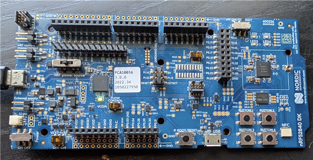

Any idea what might have caused this and how to fix it? Did I somehow brick the board? The MCU is still working fine and the board looks fine too. Interface MCU led is green. My application is running. I can even connect to SMB server using nordic Device Manager app. I tried clicking the "factory reset" button but it didn't seem to do anything.
Did you modify the DK in any way? E.g., change switch positions, cut/solder solder-bridges, etc? Please provide a picture of the DK if possible.

I didn't not modify the DK in any way and I believe all the switches are in the correct position.

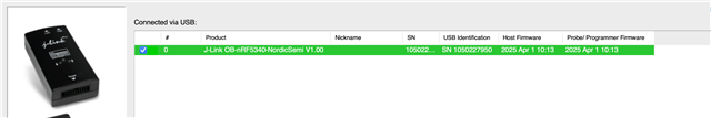

Can you try to install a newer version of J-Link, start J-Link Configuration, select the debugger and click "Update firmware of selected probes and programmers"?
Jørgen
I was able to update the debugger chip firmware but I'm still having issues with flashing.
