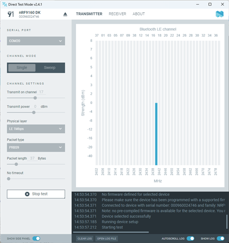

Hi, I have been experimenting with the Direct Test Mode program. I am using an nRF9160 DK, specifically the bluetooth chip nRF52840.
The Direct Test Mode is not officially supported by this dev kit, but I was able to compile it by creating a .conf file with just the following line:
CONFIG_NRFX_TIMER3=y
The program works as expected with nRF Connect's Direct Test Mode app, except that I was not able to get UART communication working. printk-commands are not getitng through, which is my main use case for the UART connection as I want to do some debugging with the printing.
Any specific tips on how to get the UART and printk working? I am lost on what I should try next.

    Hi, here are the .config and zephyr.dts files' contents.
    The VCOM port was not the problem. I had success with UART with another program. I tried all the available VCOM ports with the specified baud rates and also other baud rates with no success, so I think this is not the problem.
  • Both files look fine. I take it that you tested baud rate of 19200 and used a DTM specific application, such as our PC Direct Test Mode app, then?
    In that case, I have to try and reproduce this. The Easter holiday has just started in our location, so I might take long to answer in the upcoming 1-2 weeks. I hope you can understand.
  • Hello zachary_z,
    I was able to get the DTM test running just fine with the same steps you did.
    It was just a matter of finding the correct COM port for me.
    As for printk(), I missed this fact, but the DTM sample doesn't enable the Console (CONFIG_CONSOLE), so printk() doesn't work. That's expected, as the UART port is dedicated for the special DTM protocol.
    Could you please review your setup for anything that might have been overlooked?
