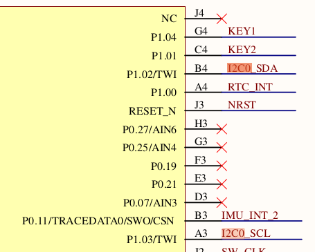

Hello everyone,
I have a custom board with an nRF5340, which currently uses the internal clock. Im using toolchain v2.9.0 and SDK 2.9.0.
I'm trying to use the RV8263-C8 RTC to achieve accurate real-time tracking.
Here is my schematic:

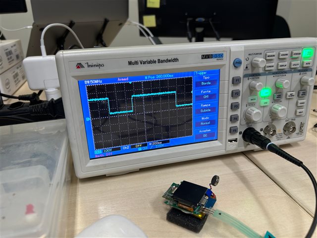

Using an oscilloscope, I observed that SDA and SCL show the same waveform.
I think there are no problems with the hardware connections. The pins are not short-circuited.
I’ve tried running other samples, but I keep getting the same issue.
When I add bias-pull-up to the pinctrl, I get a "device not ready" error.
Has anyone encountered this before or knows what might be going wrong?
Any help would be greatly appreciated!
