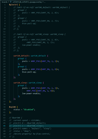

Issue of UART20 can't work when setting P2.02 as TXD and P2.00 as RXD both on the custom board and DK
Hi Support Team
UART20 of nRF54L15 can't work when setting P2.02 as TXD and P2.00 as RXD when I test the central_uart sample of NCS V2.9.1. I find that the SPI00 has used the P2.02, but UART20 still can't work after I disable the SPI00 in the overlay file. Any other configration is need for the UART20 work with P2.02 and P2.00? Many thanks.
