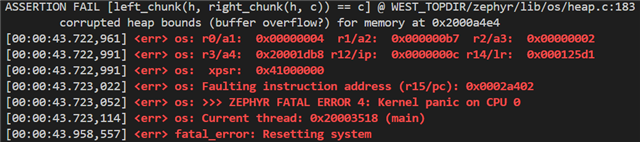

To provide some context, I am using an ANNA-B112 with nRF52832 on a custom PCB board we manufactured for evaluation. The nRF52832 is setup with the NUS service with MTU changed to 251 chars.
I have been noticing strange behavior on 1/10 of the boards. On this board, if a message is sent longer than around 70 chars, this is causing the system to have a bus fault. Here are the RTT logs from the bus fault:
ASSERTION FAIL [left_chunk(h, right_chunk(h, c)) == c] @ WEST_TOPDIR/zephyr/lib/os/heap.c:183
        corrupted heap bounds (buffer overflow?) for memory at 0x2000a364

I turned on assert and this told me there is a corrupted heap bounds error, and that it failed at the heap.c file on line 183. Before I turned on assert, the error stated a faulting instruction address which, using addr2line, lead me to heap.c file on line 58. The functions that faulted on heap.c are below:

I am starting to notice these errors more often after I had increased the heap size from 2048 to 4096. Here is my prj.conf file for context.

The error messages lead me to believe that I made some sort of memory allocation error, but since this is only affecting one device I am a little confused. I have also noticed that the one affected device is draining the LiPo battery connected to the custom board quicker than the other devices.
How can I debug this issue based on these error messages?
Thank you!
Crisvin Kadambathil
    " Current thread: 0x200033d8 (unknown)"
    If you set CONFIG_THREAD_NAME, the "unknown" will let you know which thread this is.
    Let's start with this, it usually gives some good indicators
    Sigurd Hellesvik
  • Hello Sigurd!
    I apologize for getting back to you late.
    I updated the prj.conf to set CONFIG_THREAD_NAME. And this is what I got as a result:
    It appears that the fault occurred on the main thread, so I will share that code with you as well:

    Through commenting out code, I found out that the bus fault was occurring whenever the data item from the fifo buffer was being freed using k_free. This is line 248 from the main() thread code I posted above.
    So I am still a little lost as to why k_free is causing the bus fault, why it is only happening on some devices, and why using "nrfjprog --recover" and reflashing solves the problem. Does the behavior with k_free() make any sense considering the code I have shown here?
    Thank you!
    Crisvin K.
  • I see that parse_cmd_a uses nus_command. How does parse_cmd_a look?
    I am thinking that perhaps something tries to use nus_command after it is freed?
  • Hello Sigurd,
    You are right. I went back to making a copy of the nus_command->data using memcpy. Here is the code:

    I think I also discovered what was causing the bus fault. In the previous response, I found out that the bus fault was occurring exactly at the "k_free()" line that freed the memory allocated during the bt_receive_cb callback. In the callback I was writing the data to the nus_command->data field by using "snprintf(nus_buf->data, CONFIG_BT_CTLR_DATA_LENGTH_MAX, "%s", data);" I changed this line to use memcpy instead based on an example I saw. Here is the bt_receive_cb after I changed it:
    static void bt_receive_cb(struct bt_conn *conn, const uint8_t *const data, uint16_t len)
    	struct uart_data_t *nus_buf;
    	nus_buf = k_malloc(sizeof(*nus_buf));
    	if (nus_buf == NULL)
    		// Unable to allocate memory from the heap
    		LOG_ERR("Unable to allocate memory (bt_receive_cb)");
    		return;
    	// Changed for testing
    	memcpy(nus_buf->data, data, len);
    	//snprintf(nus_buf->data, CONFIG_BT_CTLR_DATA_LENGTH_MAX, "%s", data);
    	nus_buf->len = len;
    	k_fifo_put(&nus_receive_data, nus_buf);
    This change from snprintf to memcpy has seemed to fix all the crashing issues. I even noticed that switching back to snprintf from memcpy would directly result in the bus fault.
    I am still a little confused as to why this problem didn't manifest earlier when I was developing this code, or why the problem with snprintf only seems to cause issues on some devices some of the times. However, using memcpy appears to have fixed the issue completely. Is this behavior expected?
    Thank you!
    I dont know from the top of my head. I suspect it is something specific to the snprint function, but after looking a bit around I cannot find anything that stands out. Since using memcpy works for you, I do not think I will spend more time trying to find out exactly what happened here.
