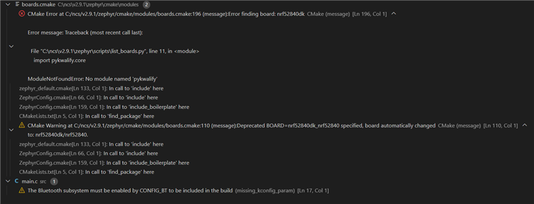

Hi!
I have been developing a GATTClient and GATTServer on two separate nrf52840dk boards and have been doing so for a long time.
This Friday I got everything to work when it comes to notifications and write without response. Offline I tried adding functionality for extending the data length and setting the PHY to 2 on the server. Once I tried to build this code and flash it to my Server the whole functionality just crashed.
It went from looking like this (GATTClient --> GATTServer) on the left and GATTServer output on the right:
To now the dev-kits are connecting but the Client does not discover the service I have built on the Server side which it has done flawlessly so far.
I THINK I have narrowed it down to some sort of Cmake issue on the Client side for some reason, and I get the following error messages in my output console of the NRF Connect for VSCode:
I have tried:
- Restarting VSCode and my computer several times.
- Updating every extension I have and also VSCode
- Re-installed the nRF Connect extension pack for VSCode
- Re-installed the SDK Toolchain to get a newer version, from 2.7.0 to 2.9.1
And still this issue is there, please help me how to proceed?
Björn
PS: Just for reference, I attach the Client code below:

  • Hi
    This CMake error is common when using NCS and VS Code, so I'm guessing you had this one before seeing these runtime issues as well.
    You say you have increased the data length and changed the PHY to 2 on the server side. Can you explain more on this. What is the new data length you've set. Is PHY 2 referring to the 2Mbps PHY or the S=2 Coded PHY (which isn't supported). Have you also set this on the client side or just on the server side? I assume the build still completes on both server and client side afterwards, and it is during runtime after flashing that it fails/crashes.
    Make sure the PHY you've set in the server side is supported on the client side as well, and how exactly and to how much did you change the data length on your end? From the latest log it seems like the MTU (throughput) is down to 23 bytes, but I assume you've increased the data length to more than 23 bytes? Please see more on maximizing Bluetooth data throughput here.
    Simon
  • Hello Simon!
    I have reverted both my Client and Server back to my last working code base and I have also tried making new builds for on both sides and it still does not work.
    I understand how throughput and maximizing it works so this is not the issue. But I can ask about this, in the Bluetooth basics course in DevAcademy, in lesson 3 exercise 2 a solution is made for data length extension and PHY, this is adaptable in my GATTServer right?
    This is my GATTServer that was working before together with the GATTClient that I have attached in the original forum post:

    On the GATTServer side I also get this output in the terminal:
    Can these be the issue?

  • Hi
    Okay, thank you for the additional info. From the latest screenshot it looks like you're trying to use the NCS v2.9.1 but that the activated toolchain is v2.6.1, which will likely cause these "outdated" messages.
    In the VS Code extension, when building your project, please make sure the SDK and toolchain versions match before pressing the build button. I attached a screenshot from a sample environment on my end. You can open a dropdown menu to choose the toolchain in the "Add Build Configuration" window.
    Simon
  • Thank you again! Yesterday after I uninstalled everything and installed it again everything started working again so I don't know if there were some driver mismatch somewhere but nonetheless now it is working again.
    Follow up question, can I use the PHY and data length extension used here: https://github.com/NordicDeveloperAcademy/bt-fund/tree/main/v2.9.0-v2.7.0/l3/l3_e2_sol
    To implement in my GATTServer/Peripheral or would this not work?
    Björn
  • Updating the PHY and data length as per the DevAcademy exercises should work just fine. Just remember that the client needs to support this as well.
    Simon
