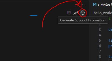

  • Hi again Nick, and thanks for waiting during the Easter holidays.
    Is there any development regarding this problem? Could you generate support info for me?
