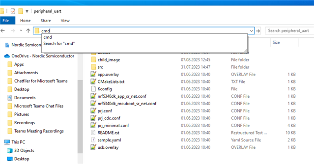

  • Which part? Flashing the build folder generated from the command line in VS Code? Or flashing from the command line?
  • Pressing the flash button from vscode fails on the build configuration, despite working in the command prompt where the ZEPHYR_BASE variable was set in.

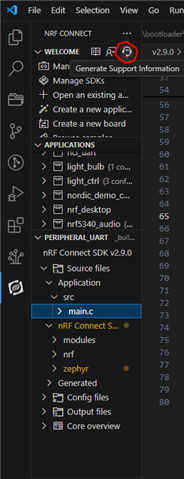

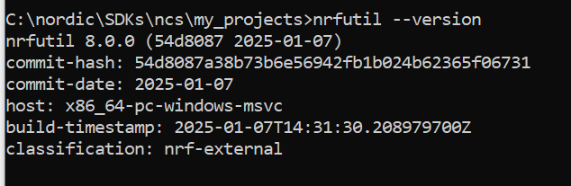

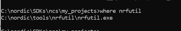

  • Do any of you have the old nrfutil installed and in your system path on your computer?
    To check, try opening a terminal in windows and type:
    "where nrfutil" (on windows, I believe it is "which nrfutil" on mac/linux):
    Does it return 0, 1 or several paths?
    Also, what does "nrfutil --version" return?
    Also, make sure you are on the latest version of "nrfutil device" using "nrfutil upgrade device":
    Does that make any difference?
    Edvin

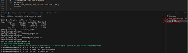

  • Hi.
    I have an older version installed (you can also check my previous nrf-connect-support file for all versions, 7.13.0, device 2.8.8 and sdk-manager 1.2.0).
    so I upgraded with nrfutil self-upgrade (to 8.0.0), followed by nrfutil upgrade device. Closed all VSCode windows and opened the new window. Same error when using the flash command. All new related versions are listed in the new support information.
    Next I tried to run from command line:

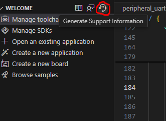

    If I open a new terminal with the command "nRF Connect: Create Shell Terminal", and paste the exact same command that fails when pressing the flash button, the build and flash works. Please see attached files for all output.
    // IMPORTANT: The following data can contain sensitive or confidential information about your environment.
    // If you do not want others to see this information, make sure to remove it before sharing the data.
    // For help and support, visit Nordic Semiconductor's DevZone at https://devzone.nordicsemi.com/.

     *  Executing task: nRF Connect: Flash: application_update/build (active)
    Flashing build to remote
    C:\Windows\system32\cmd.exe /d /s /c "west flash -d c:\ncs\v2.4.0\nrf\samples\nrf9160\http_update\application_update\build --dev-id 602005822"
    -- west flash: rebuilding
    [0/32] Performing build step for 'tfm'
    ninja: no work to do.
    [1/24] Performing build step for 'mcuboot_subimage'
    [3/22] Building C object CMakeFiles/app.dir/src/main.c.obj
    [4/22] Linking C static library app\libapp.a
    [5/22] Linking C executable zephyr\zephyr_pre0.elf
    [6/22] Generating dev_handles.c
    FAILED: zephyr/dev_handles.c
    cmd.exe /C "cd /D C:\ncs\v2.4.0\nrf\samples\nrf9160\http_update\application_update\build\zephyr && C:\ncs\toolchains\31f4403e35\opt\bin\python.exe C:/ncs/v2.4.0/zephyr/scripts/build/gen_handles.py --output-source dev_handles.c --output-graphviz dev_graph.dot --num-dynamic-devices 0 --kernel C:/ncs/v2.4.0/nrf/samples/nrf9160/http_update/application_update/build/zephyr/zephyr_pre0.elf --zephyr-base C:/ncs/v2.4.0/zephyr --start-symbol __device_start"
      File "C:/ncs/v2.4.0/zephyr/scripts/build/gen_handles.py", line 34, in <module>
        from elf_parser import ZephyrElf
      File "C:\ncs\v2.4.0\zephyr\scripts\build\elf_parser.py", line 12, in <module>
        from elftools.elf.elffile import ELFFile
      File "C:\ncs\toolchains\b620d30767\opt\bin\Lib\site-packages\elftools\elf\elffile.py", line 41, in <module>
        from ..dwarf.dwarfinfo import DWARFInfo, DebugSectionDescriptor, DwarfConfig
      File "C:\ncs\toolchains\b620d30767\opt\bin\Lib\site-packages\elftools\dwarf\dwarfinfo.py", line 17, in <module>
        from .structs import DWARFStructs
      File "C:\ncs\toolchains\b620d30767\opt\bin\Lib\site-packages\elftools\dwarf\structs.py", line 10, in <module>
        from logging.config import valid_ident
      File "<frozen zipimport>", line 259, in load_module
      File "logging\config.py", line 30, in <module>
      File "logging\handlers.py", line 26, in <module>
      File "socket.py", line 49, in <module>
    ImportError: Module use of python312.dll conflicts with this version of Python.
    FATAL ERROR: re-build in c:\ncs\v2.4.0\nrf\samples\nrf9160\http_update\application_update\build failed
    [0/30] Performing build step for 'tfm'
    [1/21] Performing build step for 'mcuboot_subimage'
    [3/19] Generating dev_handles.c
    PS C:\ncs\v2.4.0\nrf\samples\nrf9160\http_update\application_update> C:\Windows\system32\cmd.exe /d /s /c "west flash -d c:\ncs\v2.4.0\nrf\samples\nrf9160\http_update\application_update\build --dev-id [dev id]"
    [5/19] Linking C executable zephyr\zephyr_pre1.elf
    [10/19] Linking C executable zephyr\zephyr.elf
               FLASH:      127340 B       448 KB     27.76%
                 RAM:       38408 B     211608 B     18.15%
            IDT_LIST:          0 GB         2 KB      0.00%
    [14/19] Generating ../../zephyr/app_update.bin
    image.py: sign the payload
    [15/19] Generating ../../zephyr/app_signed.hex
    [17/19] Generating ../../zephyr/app_test_update.hex
    [19/19] Generating zephyr/merged.hex
    -- west flash: using runner nrfjprog
    -- runners.nrfjprog: Flashing file: c:\ncs\v2.4.0\nrf\samples\nrf9160\http_update\application_update\build\zephyr\merged.hex
    [ #################### ]   4.955s | Erase file - Done erasing
    [ #################### ]   1.185s | Program file - Done programming
    [ #################### ]   1.186s | Verify file - Done verifying
    Applying pin reset.
    -- runners.nrfjprog: Board with serial number [dev id] flashed successfully.
  • Hi.
      "platform": {
        "os": "win32",
        "osVersion": "Windows 10 Pro",
        "osKernel": "10.0.19045",
        "vscode": "1.100.2",
        "electron": "34.5.1",
        "node": "v20.19.0"
      "system": {
        "date": "2025-06-04T14:17:58.128Z",
        "vscodeRoot": "c:\\Program Files\\Microsoft VS Code\\resources\\app",
        "vscodeUptime": "00:15:42",
        "osUptime": "463:17:34",
        "cpu": "Intel(R) Core(TM) i7-10700T CPU @ 2.00GHz"
      "workspace": {
        "name": "application_update",
        "workspaceFile": null,
        "folders": [
          "c:\\ncs\\v2.4.0\\nrf\\samples\\nrf9160\\http_update\\application_update"
      "sdks": [
          "version": "v2.9.0",
          "path": "c:\\ncs\\v2.9.0"
          "version": "v2.7.0",
          "path": "c:\\ncs\\v2.7.0"
          "version": "v2.6.1",
          "path": "c:\\ncs\\v2.6.1"
          "version": "v2.5.1",
          "path": "c:\\ncs\\v2.5.1"
          "version": "v2.4.2",
          "path": "c:\\project\\customer"
          "version": "v2.4.0",
          "path": "c:\\ncs\\v2.4.0"
          "version": "v2.3.0",
          "path": "c:\\ncs\\v2.3.0"
          "version": "v2.2.0",
          "path": "c:\\ncs\\v2.2.0"
          "version": "v1.9.1",
          "path": "c:\\ncs\\v1.9.1"
          "version": "v1.5.1",
          "path": "c:\\ncs\\v1.5.1"
      "activeBuild": "c:\\ncs\\v2.4.0\\nrf\\samples\\nrf9160\\http_update\\application_update\\build",
      "apps": [
          "workspace": "c:\\ncs\\v2.4.0\\nrf\\samples\\nrf9160\\http_update\\application_update",
          "uri": "c:\\ncs\\v2.4.0\\nrf\\samples\\nrf9160\\http_update\\application_update",
          "buildConfigurations": [
              "id": "c:\\ncs\\v2.4.0\\nrf\\samples\\nrf9160\\http_update\\application_update\\build",
              "name": "build",
              "boardId": "nrf9160dk_nrf9160_ns",
              "type": "Zephyr",
              "isChild": false,
              "isStale": false,
              "taskBindings": {
                "build": [],
                "pristineBuild": [],
                "flash": [],
                "eraseAndFlash": []
              "sdk": "c:\\ncs\\v2.4.0",
              "toolchain": "nRF Connect SDK Toolchain v2.4.0"
      "toolchains": [
          "version": "2.9.0",
          "path": "c:\\ncs\\toolchains\\b620d30767"
          "version": "2.7.0",
          "path": "c:\\ncs\\toolchains\\ce3b5ff664"
          "version": "2.6.1",
          "path": "c:\\ncs\\toolchains\\cf2149caf2"
          "version": "2.5.1",
          "path": "c:\\ncs\\toolchains\\c57af46cb7"
          "version": "2.4.0",
          "path": "c:\\ncs\\toolchains\\31f4403e35"
          "version": "2.3.0",
          "path": "c:\\ncs\\toolchains\\v2.3.0"
          "version": "2.2.0",
          "path": "c:\\ncs\\toolchains\\v2.2.0"
          "version": "2.0.0",
          "path": "c:\\ncs\\toolchains\\v2.0.0"
      "connectedDevices": [
          "serialNumber": "000602005822"
      "tools": {
        "C:\\ncs\\toolchains\\31f4403e35\\opt\\zephyr-sdk\\arm-zephyr-eabi\\bin\\arm-zephyr-eabi-gcc.exe": "0.16.0",
        "C:\\Program Files\\SEGGER\\JLink_V840\\JLink.exe": "8.40",
        "C:\\Program Files\\Nordic Semiconductor\\nrf-command-line-tools\\bin\\nrfjprog.exe": "10.24.2",
        "C:\\ncs\\nrfutil\\nrfutil.exe": "8.0.0",
        "C:\\ncs\\toolchains\\31f4403e35\\cmake": "3.20.5",
        "C:\\ncs\\toolchains\\31f4403e35\\opt\\bin\\Scripts\\west.exe": "1.1.0",
        "C:\\ncs\\toolchains\\31f4403e35\\opt\\bin\\python.exe": "3.8.2",
        "C:\\ncs\\toolchains\\31f4403e35\\opt\\bin\\ninja.exe": "1.9.0",
        "C:\\ncs\\toolchains\\31f4403e35\\opt\\bin\\gperf.exe": "3.1",
        "C:\\ncs\\toolchains\\31f4403e35\\opt\\bin\\dtc.exe": "1.4.7",
        "C:\\ncs\\toolchains\\31f4403e35\\opt\\bin\\gn.exe": "2105",
        "C:\\ncs\\toolchains\\31f4403e35\\mingw64\\bin\\git.exe": "2.37.3.windows.1",
        "arm-gdbPath": "c:\\ncs\\toolchains\\31f4403e35\\opt\\zephyr-sdk\\arm-zephyr-eabi\\bin\\arm-zephyr-eabi-gdb.exe",
        "riscv-gdbPath": "not found"
      "nrfutil": {
        "nrfutil-device": {
          "version": "2.8.8",
          "binPath": "c:\\Users\\ErlendEliasIsachsen\\.vscode\\extensions\\nordic-semiconductor.nrf-connect-2025.5.92-win32-x64\\platform\\nrfutil\\bin\\nrfutil-device",
          "jlinkInfo": {
            "description": "This version of SEGGER J-Link is different from the J-Link version that was used to test nrfutil device commands",
            "expectedVersion": {
              "version": "JLink_V8.18",
              "versionFormat": "string"
            "name": "JlinkARM",
            "version": "JLink_V8.40",
        "nrfutil-sdk-manager": {
          "version": "1.3.0",
          "binPath": "c:\\Users\\ErlendEliasIsachsen\\.vscode\\extensions\\nordic-semiconductor.nrf-connect-2025.5.92-win32-x64\\platform\\nrfutil\\bin\\nrfutil-sdk-manager"
      "environment": {
        "westEnv": {
          "HOME": "C:\\SPB_Data",
          "HOMEDRIVE": "C:",
          "HOMEPATH": "\\Users\\ErlendEliasIsachsen",
          "PATH": "C:\\ncs\\toolchains\\b620d30767;C:\\ncs\\toolchains\\b620d30767\\mingw64\\bin;C:\\ncs\\toolchains\\b620d30767\\bin;C:\\ncs\\toolchains\\b620d30767\\opt\\bin;C:\\ncs\\toolchains\\b620d30767\\opt\\bin\\Scripts;C:\\ncs\\toolchains\\b620d30767\\opt\\nanopb\\generator-bin;C:\\ncs\\toolchains\\b620d30767\\opt\\zephyr-sdk\\arm-zephyr-eabi\\bin;C:\\ncs\\toolchains\\b620d30767\\opt\\zephyr-sdk\\riscv64-zephyr-elf\\bin;c:\\Users\\ErlendEliasIsachsen\\.vscode\\extensions\\nordic-semiconductor.nrf-connect-2025.5.92-win32-x64\\platform\\nrfutil\\lib\\nrfutil-sdk-manager;C:\\Program Files (x86)\\NVIDIA Corporation\\PhysX\\Common;C:\\Windows\\system32;C:\\Windows;C:\\Windows\\System32\\Wbem;C:\\Windows\\System32\\WindowsPowerShell\\v1.0\\;C:\\Windows\\System32\\OpenSSH\\;C:\\Program Files\\Microchip\\xc8\\v2.31\\bin;C:\\Program Files\\PuTTY\\;C:\\Program Files\\WinMerge;C:\\Program Files\\dotnet\\;C:\\Program Files\\Wolfram Research\\WolframScript\\;C:\\Program Files (x86)\\Windows Kits\\8.1\\Windows Performance Toolkit\\;C:\\Program Files\\Git\\cmd;C:\\Program Files\\Microsoft VS Code\\bin;C:\\Program Files\\LLVM\\bin;C:\\Program Files\\TortoiseSVN\\bin;C:\\Program Files\\otii;C:\\Program Files\\doxygen\\bin;C:\\Program Files\\Graphviz\\bin;C:\\Program Files\\Nordic Semiconductor\\nrf-command-line-tools\\bin\\;C:\\Program Files\\CMake\\bin;C:\\ncs\\nrfutil;C:\\gnuarmemb\\9_2019-q4-major\\bin;C:\\Users\\ErlendEliasIsachsen\\AppData\\Local\\Microsoft\\WindowsApps;C:\\Users\\ErlendEliasIsachsen\\.dotnet\\tools;C:\\Users\\ErlendEliasIsachsen\\AppData\\Local\\GitHubDesktop\\bin;C:\\Users\\ErlendEliasIsachsen\\AppData\\Local\\Programs\\MiKTeX\\miktex\\bin\\x64\\;",
          "ZEPHYR_BASE": "c:\\ncs\\v2.4.0\\zephyr",
          "ZEPHYR_SDK_INSTALL_DIR": "C:\\ncs\\toolchains\\b620d30767\\opt\\zephyr-sdk",
          "PYTHONPATH": "C:\\ncs\\toolchains\\b620d30767\\opt\\bin;C:\\ncs\\toolchains\\b620d30767\\opt\\bin\\Lib;C:\\ncs\\toolchains\\b620d30767\\opt\\bin\\Lib\\site-packages"
        "inherited": {
          "HOMEDRIVE": "C:",
          "Path": "C:\\Program Files (x86)\\NVIDIA Corporation\\PhysX\\Common;C:\\Windows\\system32;C:\\Windows;C:\\Windows\\System32\\Wbem;C:\\Windows\\System32\\WindowsPowerShell\\v1.0\\;C:\\Windows\\System32\\OpenSSH\\;C:\\Program Files\\Microchip\\xc8\\v2.31\\bin;C:\\Program Files\\PuTTY\\;C:\\Program Files\\WinMerge;C:\\Program Files\\dotnet\\;C:\\Program Files\\Wolfram Research\\WolframScript\\;C:\\Program Files (x86)\\Windows Kits\\8.1\\Windows Performance Toolkit\\;C:\\Program Files\\Git\\cmd;C:\\Program Files\\Microsoft VS Code\\bin;C:\\Program Files\\LLVM\\bin;C:\\Program Files\\TortoiseSVN\\bin;C:\\Program Files\\otii;C:\\Program Files\\doxygen\\bin;C:\\Program Files\\Graphviz\\bin;C:\\Program Files\\Nordic Semiconductor\\nrf-command-line-tools\\bin\\;C:\\Program Files\\CMake\\bin;C:\\ncs\\nrfutil;C:\\gnuarmemb\\9_2019-q4-major\\bin;C:\\Users\\ErlendEliasIsachsen\\AppData\\Local\\Microsoft\\WindowsApps;C:\\Users\\ErlendEliasIsachsen\\.dotnet\\tools;C:\\Program Files\\TortoiseSVN\\bin;C:\\Users\\ErlendEliasIsachsen\\AppData\\Local\\GitHubDesktop\\bin;C:\\Users\\ErlendEliasIsachsen\\AppData\\Local\\Programs\\MiKTeX\\miktex\\bin\\x64\\;",
          "PATH": "C:\\Program Files (x86)\\NVIDIA Corporation\\PhysX\\Common;C:\\Windows\\system32;C:\\Windows;C:\\Windows\\System32\\Wbem;C:\\Windows\\System32\\WindowsPowerShell\\v1.0\\;C:\\Windows\\System32\\OpenSSH\\;C:\\Program Files\\Microchip\\xc8\\v2.31\\bin;C:\\Program Files\\PuTTY\\;C:\\Program Files\\WinMerge;C:\\Program Files\\dotnet\\;C:\\Program Files\\Wolfram Research\\WolframScript\\;C:\\Program Files (x86)\\Windows Kits\\8.1\\Windows Performance Toolkit\\;C:\\Program Files\\Git\\cmd;C:\\Program Files\\Microsoft VS Code\\bin;C:\\Program Files\\LLVM\\bin;C:\\Program Files\\TortoiseSVN\\bin;C:\\Program Files\\otii;C:\\Program Files\\doxygen\\bin;C:\\Program Files\\Graphviz\\bin;C:\\Program Files\\Nordic Semiconductor\\nrf-command-line-tools\\bin\\;C:\\Program Files\\CMake\\bin;C:\\ncs\\nrfutil;C:\\gnuarmemb\\9_2019-q4-major\\bin;C:\\Users\\ErlendEliasIsachsen\\AppData\\Local\\Microsoft\\WindowsApps;C:\\Users\\ErlendEliasIsachsen\\.dotnet\\tools;C:\\Program Files\\TortoiseSVN\\bin;C:\\Users\\ErlendEliasIsachsen\\AppData\\Local\\GitHubDesktop\\bin;C:\\Users\\ErlendEliasIsachsen\\AppData\\Local\\Programs\\MiKTeX\\miktex\\bin\\x64\\;"
      "terminal": {
        "defaultProfile": null
      "config": {
          "topdir": "",
          "toolchain": {
            "path": ""
          "ozonePath": "",
          "applications": [],
          "applicationOptions": {},
          "kconfig": {
            "interface": "kconfig"
          "west": {
            "env": {
              "$base": "terminal"
          "boardRoots": [],
          "taskBindings": {},
          "buildTerminal": {
            "condensedProgress": true
          "debugging": {
            "flash": true,
            "bindings": {},
            "justMyCode": false
          "flash": {
            "softreset": false,
            "erase": false,
            "recover": false
          "enableTelemetry": true,
          "thirdpartyIntegration": {},
          "toolchainManager": {
            "indexURL": null,
            "installDirectory": null
          "nrfutil": {
            "home": null
          "defaultOpenAction": "ask",
          "terminalProfile": {
            "shell": null
          "terminalMode": "character"
        "marus25.cortex-debug": {
          "variableUseNaturalFormat": true,
          "liveWatchRefreshRate": "300",
          "armToolchainPath": null,
          "armToolchainPrefix": "arm-none-eabi",
          "gdbPath": null,
          "objdumpPath": null,
          "JLinkGDBServerPath": null,
          "openocdPath": null,
          "pyocdPath": null,
          "PEGDBServerPath": null,
          "stutilPath": null,
          "stlinkPath": null,
          "stm32cubeprogrammer": null,
          "dbgServerLogfile": null
      "extensions": {
        "internal": {
            "version": "2025.5.92",
            "path": "c:\\Users\\ErlendEliasIsachsen\\.vscode\\extensions\\nordic-semiconductor.nrf-connect-2025.5.92-win32-x64",
            "isActive": true
            "version": "2024.9.14",
            "path": "c:\\Users\\ErlendEliasIsachsen\\.vscode\\extensions\\nordic-semiconductor.nrf-terminal-2024.9.14",
            "isActive": true
            "version": "2025.4.22",
            "path": "c:\\Users\\ErlendEliasIsachsen\\.vscode\\extensions\\nordic-semiconductor.nrf-devicetree-2025.4.22",
            "isActive": true
            "version": "2025.4.26",
            "path": "c:\\Users\\ErlendEliasIsachsen\\.vscode\\extensions\\nordic-semiconductor.nrf-kconfig-2025.4.26",
            "isActive": true
        "external": {
          "marus25.cortex-debug": "1.12.1",
          "ms-vscode.cpptools": "1.26.1",
          "ms-vscode.js-debug": "1.100.1",
          "ms-vscode.js-debug-companion": "1.1.3",
          "ms-vscode.vscode-js-profile-table": "1.0.10",
          "bbenoist.Doxygen": "1.0.0",
          "cschlosser.doxdocgen": "1.4.0",
          "DotJoshJohnson.xml": "2.5.1",
          "GitHub.copilot": "1.326.0",
          "GitHub.copilot-chat": "0.27.3",
          "joaompinto.vscode-graphviz": "0.0.9",
          "josetr.cmake-language-support-vscode": "0.0.9",
          "KevinRose.vsc-python-indent": "1.21.0",
          "mcu-debug.debug-tracker-vscode": "0.0.15",
          "mcu-debug.memory-view": "0.0.25",
          "mcu-debug.peripheral-viewer": "1.4.6",
          "mcu-debug.rtos-views": "0.0.7",
          "ms-dotnettools.vscode-dotnet-runtime": "2.3.5",
          "ms-python.debugpy": "2025.8.0",
          "ms-python.python": "2025.6.1",
          "ms-python.vscode-pylance": "2025.5.1",
          "ms-vscode-remote.remote-containers": "0.413.0",
          "ms-vscode-remote.remote-ssh": "0.120.0",
          "ms-vscode-remote.remote-ssh-edit": "0.87.0",
          "ms-vscode-remote.remote-wsl": "0.99.0",
          "ms-vscode.cpptools-extension-pack": "1.3.1",
          "ms-vscode.remote-explorer": "0.5.0",
          "redhat.vscode-xml": "0.29.0",
          "tintinweb.graphviz-interactive-preview": "0.3.5",
          "tomoki1207.pdf": "1.2.2",
          "xaver.clang-format": "1.9.0"
    *  Executing task: nRF Connect: Generate config nrf9160dk_nrf9160_ns for c:\ncs\v2.4.0\nrf\samples\nrf9160\http_update\application_update
    Building application_update
    C:\Windows\system32\cmd.exe /d /s /c "west build --build-dir c:/ncs/v2.4.0/nrf/samples/nrf9160/http_update/application_update/build c:/ncs/v2.4.0/nrf/samples/nrf9160/http_update/application_update --pristine --board nrf9160dk_nrf9160_ns -- -DNCS_TOOLCHAIN_VERSION=NONE"
    -- Application: C:/ncs/v2.4.0/nrf/samples/nrf9160/http_update/application_update
    -- CMake version: 3.20.5
    -- Found Python3: C:/ncs/toolchains/31f4403e35/opt/bin/python.exe (found suitable exact version "3.8.2") found components: Interpreter
    -- Cache files will be written to: C:/ncs/v2.4.0/zephyr/.cache
    -- Zephyr version: 3.3.99 (C:/ncs/v2.4.0/zephyr)
    -- Found west (found suitable version "1.1.0", minimum required is "0.7.1")
    -- Board: nrf9160dk_nrf9160_ns, Revision: 0.7.0
    -- Found host-tools: zephyr 0.16.0 (C:/ncs/toolchains/31f4403e35/opt/zephyr-sdk)
    -- Found toolchain: zephyr 0.16.0 (C:/ncs/toolchains/31f4403e35/opt/zephyr-sdk)
    -- Found Dtc: C:/ncs/toolchains/31f4403e35/opt/bin/dtc.exe (found suitable version "1.4.7", minimum required is "1.4.6")
    -- Found BOARD.dts: C:/ncs/v2.4.0/zephyr/boards/arm/nrf9160dk_nrf9160/nrf9160dk_nrf9160_ns.dts
    -- Generated zephyr.dts: C:/ncs/v2.4.0/nrf/samples/nrf9160/http_update/application_update/build/zephyr/zephyr.dts
    -- Generated devicetree_generated.h: C:/ncs/v2.4.0/nrf/samples/nrf9160/http_update/application_update/build/zephyr/include/generated/devicetree_generated.h
    -- Including generated dts.cmake file: C:/ncs/v2.4.0/nrf/samples/nrf9160/http_update/application_update/build/zephyr/dts.cmake
    Parsing C:/ncs/v2.4.0/nrf/samples/nrf9160/http_update/application_update/Kconfig
    Loaded configuration 'C:/ncs/v2.4.0/zephyr/boards/arm/nrf9160dk_nrf9160/nrf9160dk_nrf9160_ns_defconfig'
    Merged configuration 'C:/ncs/v2.4.0/nrf/samples/nrf9160/http_update/application_update/prj.conf'
    Configuration saved to 'C:/ncs/v2.4.0/nrf/samples/nrf9160/http_update/application_update/build/zephyr/.config'
    Kconfig header saved to 'C:/ncs/v2.4.0/nrf/samples/nrf9160/http_update/application_update/build/zephyr/include/generated/autoconf.h'
    -- Found GnuLd: c:/ncs/toolchains/31f4403e35/opt/zephyr-sdk/arm-zephyr-eabi/bin/../lib/gcc/arm-zephyr-eabi/12.2.0/../../../../arm-zephyr-eabi/bin/ld.bfd.exe (found version "2.38")
    -- Found assembler: C:/ncs/toolchains/31f4403e35/opt/zephyr-sdk/arm-zephyr-eabi/bin/arm-zephyr-eabi-gcc.exe
    -- Found Python3: C:/ncs/toolchains/31f4403e35/opt/bin/python.exe (found version "3.8.2") found components: Interpreter
    Changed board to secure nrf9160dk_nrf9160 (NOT NS)
    === child image mcuboot -  begin ===
    loading initial cache file C:/ncs/v2.4.0/nrf/samples/nrf9160/http_update/application_update/build/mcuboot/child_image_preload.cmake
    CMake Warning (dev) at C:/ncs/v2.4.0/nrf/samples/nrf9160/http_update/application_update/build/mcuboot/child_image_preload.cmake:8 (set):
      Syntax error in cmake code at
      when parsing string
      Invalid escape sequence \3
      Policy CMP0010 is not set: Bad variable reference syntax is an error.  Run
      "cmake --help-policy CMP0010" for policy details.  Use the cmake_policy
      command to set the policy and suppress this warning.
    This warning is for project developers.  Use -Wno-dev to suppress it.
    -- Application: C:/ncs/v2.4.0/bootloader/mcuboot/boot/zephyr
    -- Board: nrf9160dk_nrf9160, Revision: 0.7.0
    -- Found BOARD.dts: C:/ncs/v2.4.0/zephyr/boards/arm/nrf9160dk_nrf9160/nrf9160dk_nrf9160.dts
    -- Found devicetree overlay: C:/ncs/v2.4.0/bootloader/mcuboot/boot/zephyr/app.overlay
    -- Generated zephyr.dts: C:/ncs/v2.4.0/nrf/samples/nrf9160/http_update/application_update/build/mcuboot/zephyr/zephyr.dts
    -- Generated devicetree_generated.h: C:/ncs/v2.4.0/nrf/samples/nrf9160/http_update/application_update/build/mcuboot/zephyr/include/generated/devicetree_generated.h
    -- Including generated dts.cmake file: C:/ncs/v2.4.0/nrf/samples/nrf9160/http_update/application_update/build/mcuboot/zephyr/dts.cmake
    Parsing C:/ncs/v2.4.0/bootloader/mcuboot/boot/zephyr/Kconfig
    Loaded configuration 'C:/ncs/v2.4.0/zephyr/boards/arm/nrf9160dk_nrf9160/nrf9160dk_nrf9160_defconfig'
    Merged configuration 'C:/ncs/v2.4.0/bootloader/mcuboot/boot/zephyr/prj.conf'
    Merged configuration 'C:/ncs/v2.4.0/nrf/modules/mcuboot/tfm.conf'
    Merged configuration 'C:/ncs/v2.4.0/nrf/modules/mcuboot/fih_low_enable.conf'
    Merged configuration 'C:/ncs/v2.4.0/nrf/subsys/partition_manager/partition_manager_enabled.conf'
    Merged configuration 'C:/ncs/v2.4.0/nrf/samples/nrf9160/http_update/application_update/build/mcuboot/zephyr/misc/generated/extra_kconfig_options.conf'
    Configuration saved to 'C:/ncs/v2.4.0/nrf/samples/nrf9160/http_update/application_update/build/mcuboot/zephyr/.config'
    Kconfig header saved to 'C:/ncs/v2.4.0/nrf/samples/nrf9160/http_update/application_update/build/mcuboot/zephyr/include/generated/autoconf.h'
    CMake Warning at C:/ncs/v2.4.0/zephyr/CMakeLists.txt:838 (message):
      No SOURCES given to Zephyr library: lib__libc__common
      Excluding target from build.
    MCUBoot bootloader key file: C:/ncs/v2.4.0/bootloader/mcuboot/root-ec-p256.pem
    -- Configuring done
    -- Generating done
    -- Build files have been written to: C:/ncs/v2.4.0/nrf/samples/nrf9160/http_update/application_update/build/mcuboot
    === child image mcuboot -  end ===
    CMake Warning at C:/ncs/v2.4.0/nrf/modules/mcuboot/CMakeLists.txt:310 (message):
              --- WARNING: Using default MCUBoot key, it should not ---
              --- be used for production.                           ---
    Applying pin reset.

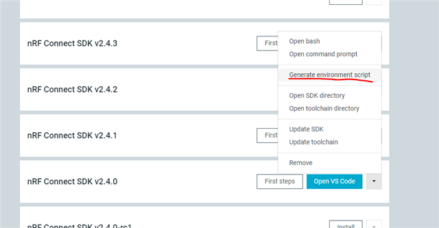

  • I understand. We are struggling with reproducing this issue at the moment, but I have forwarded all your logs and generated support information to our VS Code extension team, so right now I don't know if I can do much more. I will get back to you in this ticket when I know more.
    In the meantime, I suggest that you build and flash in a command window, outside the VS Code (but you can still use VS Code to navigate, and write code, and open your current build folder, for debugging purposes).
    If so, I recommend that you set up a neat way to activate the toolchain and SDK location through a simple command.
    One easy way to do this, up until v3.0.0 (not working on v3.0.0 or newer) is to use the nRF Connect for Desktop -> Toolchain manager, and Generate Environment script:
    This will generate a .cmd file containing all paths that you need. Call it full_environment_2.4.0.cmd. Place it in a folder, and put that folder in your computer's path, so that it will be found from wherever you are running a command line.
    Then, you can create a file, and call it "NCS_v2.4.0.bat", or something like that, and place it in the same folder. In that file, write the following:
    @echo off
    echo Setting up full Zephyr environment...
    call full_environment_2.4.0.cmd
    echo done!
    Now, you should be able to open a command window in any folder by writing "cmd" where the path is usually written:
    And hit enter. This will open a terminal in that folder. In there, type "NCS_v2.4.0", and it will print:
    done!
    And from there, you can use all west commands, like "west build -b nrf52840dk_nrf52840 -d build", "west flash -d build", and so on. Also note that when you make changes to an application with an exisiting build folder, you don't need to specify the board name to re-build it. Just use:
    "west build -d <name of build folder>"
    This works up until v2.9.1 (or any feature v2.9.X releases)
    For NCS v3.0.0 and onwards, you need to use nrfutil to generate these environment scripts.
    nrfutil sdk-manager env --as-script --ncs-version v3.0.1
    This will give you almost the same as the generated environment script, but just as an output in the terminal. Copy it, and save it in a file called full_environment_v3.0.1.cmd, and save it in the same folder as your other scripts.
    Just on the end, add one line:
    SET ZEPHYR_BASE=C:\nordic\SDKs\ncs\v3.0.1\zephyr
    (but replace the path to your NCS v3.0.1\zephyr)
    Edvin
  • Thank you for the advice.
    For anyone else struggling with the same issue, I want to add that you can alternatively use version 2024.12.55 of the nRF Connect extension. This version works for me, and I can flash etc. normally. To install a specific version in VSCode, navigate to extensions -> nRF Connect for VS code and click the arrow next to "uninstall", and select "install specific version...". Not sure how well it works with the very latest versions of SDK/toolchain, but I have used it the last 6 months or so without any problems.
