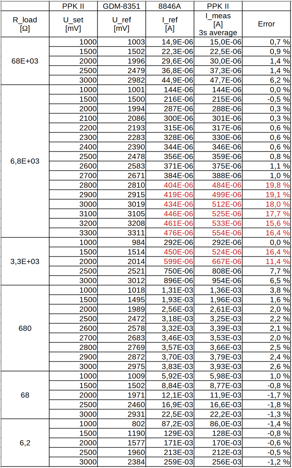

I made some tests with PPK-II in source meter mode by connecting a load resistor in series with a Fluke 8846A ampere meter to the PPK output. A also hooked a GW Instek GDM-8351 voltmeter in parallel to the PPK output.
Here are the results:
The PPK is out of spec around 500uA. From time to time, while changing the output voltage up and down, those red values suddenly got much better, in accordance with the +/-10% specified max. error. But I couldn't figure out what exactly makes the PPK suddenly jump in/out of spec. However, most of the time I observed the large errors from the table above.
Given the described behavior, I suspect a FW error in range changing logic. Are you aware of this? Can this be fixed in a future FW upgrade?

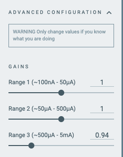

    During testing on my PPK2, I observe that measurement range 3 (0.5 mA - 5 mA) shows an offset of about 100 µA. For a load in the 500 µA range, the accuracy depends on whether PPK2 uses range 2 or range 3. Note that the range selection is done purely in hardware, and cannot be directly controlled from firmware.
    I can compensate by changing the gain for this particular range under "Advanced configuration":
    It might be possible to improve the calculation done on the Power Profiler side, but I have no timeline for when we might look into this.

    Second thought, I find it hard to imagine that this is a gain problem in any particular range because I get correct results both in the 50uA-500uA range well below 500uA as well as at the 500uA-5mA range well above 500uA.
    I saw in the schematic that the range switching is indeed fully automatic by the HW. I checked the state of some test points at different output voltages:
    U_set=2600mV
    R_load=6k8
    I_meas=380uA
    U_set=2700mV
    R_load=6k8
    I_meas=478uA
    U_set=2700mV
    R_load=3k3
    I_meas=870uA
    U_set=2700mV
    R_load=1k0
    I_meas=2.75mA
    TP30 3.3V 3.3V 3.3V 3.3V
    TP31 0V 3.3V 3.3V 3.3V
    TP32 0V 0V 0V 0V
    TP33 0V 0V 0V 0V
    TP3 1.56V 0.22V 0.38V 1.13V
    TP21 60mV 60mV 60mV 60mV
    The problematic behaviour is thus at the lower end of the 500uA-5mA range, and it doesn't seem to be caused by the offset dictated by POT 3 (TP21).
    If it's not the FW, could it be some non-linearities in the FETs through which the measured current passes (Q2, Q16, Q5, Q7)?
    This was what I observed also, which made me wonder if it was a calibration error that could be corrected with some gain. But as you point out, only the lower end is problematic, so a different curve might have to be applied here. I have not yet investigated if the calibration data with generate during PPK2 production is sufficient. This is the kind of improvement I can't provide a timeline for.
    I can create a local version of Power Profiler that applies a curve that improves my particular PPK2 in this range, and we can see if it makes an improvement for you. If this looks like a viable approach we can try to assign resources to more thoroughly test this.
    Thanks for checking the shell metrics by the way. The low number of "samples dropped" indicates it is likely not an issue with the FW detecting the wrong measurement range.
