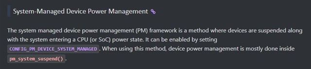

pm_system_suspend() is flagged as warning: implicit declaration of function 'pm_system_suspend' [-Wimplicit-function-declaration] even when CONFIG_PM_DEVICE_SYSTEM_MANAGED = y. https://docs.zephyrproject.org/latest/services/pm/device.html

  • Thanks. As far as I know the 52 series only support the power state system on and system off as mention here. Regarding pm_system_suspend() that is not a function you should call, but it is called by the kernel to inform listeners if enabled by CONFIG_PM. You can read more about the Zephyr power management system here.
