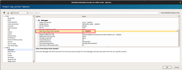

  • Error code says SD was already enabled.
    Maybe you have another code path that enabled it, maybe you have a bootloader present that forgot to disable SD before switching to the app.
  • Thank you for the answer. Just want to add that this can also happen if the debugger forces execution to start at FLASH_START instead of address 0x0. This leads to the Softdevice not being initialized on startup, thus not being in a valid state when the app tries to enable it. Do you see the same error if you reset the board (power cycle or pin reset)?
  • I am not using a bootloader, and I have already implemented a check to ensure that the SoftDevice is only enabled once:
    if (!nrf_sdh_is_enabled()) { NRF_LOG_INFO("Enabling SoftDevice..."); err_code = nrf_sdh_enable_request(); APP_ERROR_CHECK(err_code); } else { NRF_LOG_WARNING("SoftDevice already enabled"); }
    Despite this, the issue still persists.
    Even after a full power cycle, the same behavior occurs — the call to sd_softdevice_enable() returns NRF_ERROR_INVALID_STATE (8).
