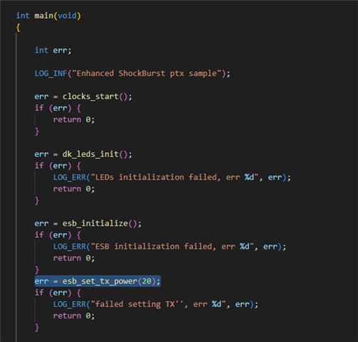

    For esb_ptx, I have added the code in my previous comment what you need to add in the main.c file of esb_ptx sample.

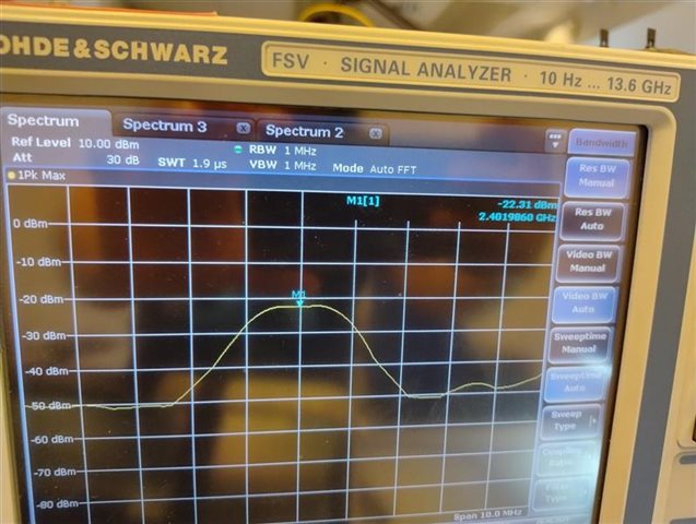

    I did some test in the lab by watching the improvement of TX output on the spectrum analyzer. Because -60 to -73 dbm (which we saw in the putty output as RSSI) is not optimal at all. So, the idea was to check the TX output. TX output power did not show any improvement on the spectrum analyzer which proved some pins of the Pin did not work.
    I checked the FEM pin (PDN, TX, RX and PDN) on the nRF21540 if those were working properly. When we forcefully made the PDN pin up by connecting the pin to vdd then I got the tx value on spectrum analyzer. The RSSI value
    You can try to do the same on your nRF21540 DK.
    I also have made little changed in the code. Hvae set CONFIG_MPSL_FEM_NRF21540_TX_GAIN_DB=20 in the prj.conf file. Now esb_set_tx_power(20) function is declared as an error return after some activities (clock_start(), dk_kleds_init(), esb_initialize()) and
    Got this as output on the spectrum analyzer which proves PDN is working(after this forcefully made it up)
    and improved RSSI value

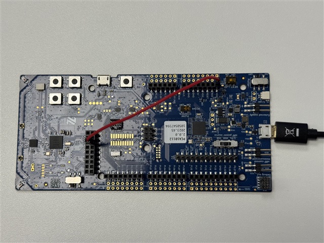

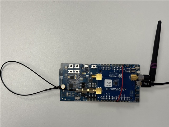

    When I manually forced the PDN pin high by connecting it to VDD, I achieved proper TX power on my setup using the nRF52840-DK with the nRF21540-EK. The RSSI value in my ESB example increased by 25 dBm.
    I applied the same workaround on the nRF21540-DK, which previously had almost no output. After forcing the PDN pin high on that board as well, it started functioning correctly, and I observed excellent reception on the PRX side.
    Conclusion:
    The current workaround is to manually force the PDN pin high by connecting it to VDD. However, this is clearly not a proper solution. I believe the hardware is working correctly, and—as I have been pointing out for over six months across multiple support requests—this confirms that there is indeed a bug in the Nordic Connect SDK (versions 2.8.0, 2.9.0, and newer).

    Photo 1: nRF52840-DK + nRF21540-EK (with wire connecting PDN to VDD)
    Photo 2: nRF21540-DK (with wire connecting PDN to VDD)
