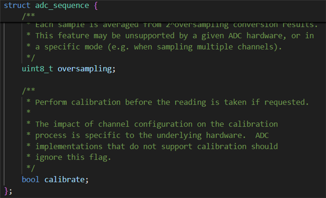

I am using nRF54L15 with Zephyr to measure voltage with ADC. In the struct adc_sequence there is a calibrate bool, but I am not sure what it does. What is the reference that the MCU do this calibration on?
I believe that the MCU has already a ADC calibrate value (or several values, due to temperature offset, ADC gain & offset error, ...) when it is tested at factory, and this value can be stored in the memory. Does the nRF54L15 have this value and can I get/read it from memory?

    The SAADC in the nRF54L15 doesn't have such calibration data stored in memory. Instead, it can calibrate itself, and the calibration can be triggered by the application/firmware.
    Considering that fact and the comment above the calibrate flag, I would understand that the flag controls whether a calibrate is automatically done before each sampling.
