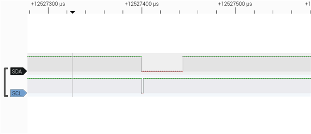

I have problem with i2c that can't read the cst816s, its always return log message `<err> cst816s: failed reading chip id` and `<err> cst816s: Could not read x data` when touched. i'm using the nRF52832. is there any configuration i need to do?

    Are you able to get logic analyzer or oscilloscope readings from the I2C?
    Sigurd Hellesvik
  • Hi, thanks for your response. As you can see, there is nothing on the i2c reading with zephyr. I have tried it with other frameworks and it still works fine. I'm still curious what makes i2c (with gpio sda 9 and gpio scl 10) not output any data, maybe I missed something when setting up the board devicetree or overlay.
    I2c readings with other framework:
    I2c readings with zephyr:
  • Looks like you are using the cst816s drivers directly.
    I found a Zephyr issue where another user has exactly the same issue:
    https://github.com/zephyrproject-rtos/zephyr/discussions/74678. Im not sure if it is related or not, but worth knowing about.
    This is good to know. It shows that the hardware works correctly, and that this is a software issue.
    I suggest that you start by trying to use I2C directly to read the device ID.
    You can do this by following the DevAcademy Fundamentals: I2C lesson.
    This way, you get some firmware to compare with. Then we can compare the working I2C with the cst816s driver.

  • nanangcreacoll said:
    I try directly using I2C to initialize CST816S. I try to make my own device tree binding for CST816S. I still don't know which part I should fix, I2C still can't read the chip. RST and IRQ gpio work fine.
    Alright, then we have tried two different ways to read the CST816S over I2C.
    At this point, I think it would be a good idea to look at the hardware.
    How do you connect the CST to the nRF?
    Do you have another I2C device that you can try to read with the nRF, to verify that the I2C code work?
