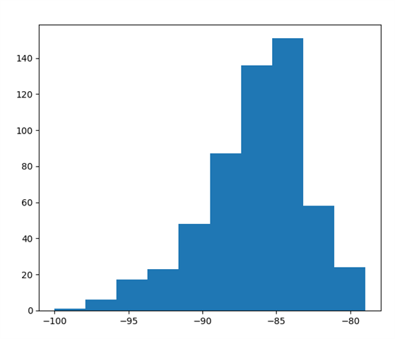

I'm currently testing BLE Coded PHY by using extended advertising.
I used two nRF52840-DK and nRF5 SDK v17 with compatible softDevice.
I've checked that the hardware oprates in Coded PHY (both primary and secondary advertising channel),
and there is no problem to set the Coded PHY option. However, when I compared a communication range
of Coded PHY(1) with the range of Legacy advertising(2), Both setup has almost same range in LoS condition.
One of the two nRF52840-DK was used as scanner, and the other one was used as peripheral
(beacon with extended or legacy advertising). Beacon Tx power set to +8 dBm.
My question is...
1) Is it correct or possible both Coded PHY (extended adv.) and LE 1M PHY (legacy adv.) range to be similar ... ?
Most of results of other developers represented that Coded PHY's range is almost doubled of LE 1M, but
in my case there is no significant difference. Repeatedly, I've already checked the PHY option was correctly changed.
2) Including the datasheet, many blog posts said that the Rx sensitivity of nRF52840 SoC in Coded PHY (125kbps) is up to -103 dBm.
However, in my case, there is no significant difference on RSSI betweeen LE 1M Scanner vs Coded PHY Scanner. Even though
I select to scan Coded PHY, the minimum RSSI of the received (extended) advertising packet is just -95 dBm. Is there any
option to receive the advertising packet of smaller RSSI about -95 ~ -103 dBm level...?

  • Oh, I'm sorry, I didn't mention the range.
    1. When I tested outdoor, the range between scanner and beacon is about 500 m.. and There is a little difference, but both legacy advertising and extended advertising with Coded PHY had similar communication ragne.
    2. This is my Coded PHY setup.
    (1) First to changed LE PHY option, I used "Extended Advertising"
    (2) Extended advertsing use two types of advertising channel (primary and secondary), and I set the both channel as Coded PHY
    (3) When I receiving Coded PHY signal, the scanner also scanned "Coded PHY" layer, and it is only possible to receive beacon packet which was set to Coded PHY
    (4) At last, I used an additional nRF52840-DK to operate nRF sniffer tools with Wireshart software, and I've checked the beacon packet uses Coded PHY (S=8) when i've set as it.
    When I confirmed the sniffer log, the captured packet also didn't go down to -103 dbm..
    Is this level (-103 dBm) of RSSI is only possible in connection mode?
    My interest is advertising-based communication (which using Beacon), with Coded PHY..
    The following is a part of my code to initialize beacon and scanner.
    Isn't it Coded PHY (Long-range mode) Setup? Is there any setup did i missed?
    Please confirm the below code (nRF5 SDK v17, s140 7.2.0 softdevice)

    We've tested further by using other nRF5 SDK version and softdevice, even using s340 6.1.1. However we didn't get the -103 dBm sensitivity. The minimum sensitivity we confirmed is -100 dBm, It is only captured one-times
    I know there are some examples and results about long-ragne test, but i can not found that those experiments were conducted by practical advertising (beacon) based application. For example, advertiser transmitted the "iBeacon or Eddystone" format and scanner received the data. In this case, RSSI could go down to -103 dBm.
    I'v just thought about that we can get the -103 dBm sensitivity with regular interval, even previously I mentioned scenario. But, I think that RSSI level might be focused on "1 symbol" level, not the overall Link layer packet. So, by using the ATT experiment example, some people get the low RSSI value, but it might be not guarantee in the case of scanning link layer scenario. The below figure is histogram of RSSI value we've got
