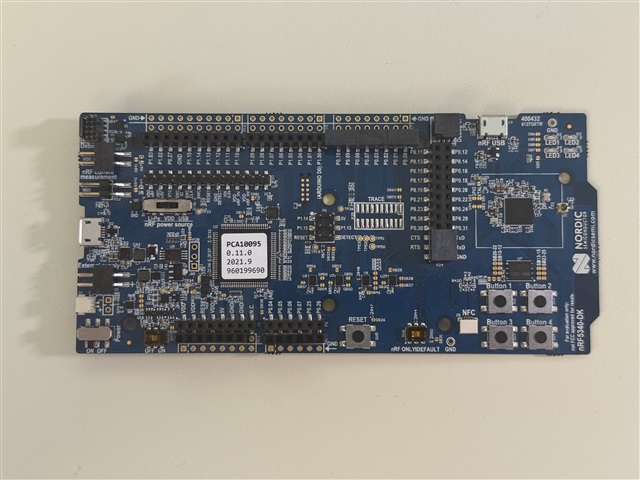

I am having issues programming my nrf5340dk through VSCode or the nrfjprog tools. I have tried as many remedies I can find on the DevZone but not of them seem to correct my issue.
When I attempt to flash my board, the terminal indicates JLink is not supported by current CPU + target interface combination and exits with error code: 33. I sometimes see the same error when issuing the 'nrfjprog --recover' command.
One DevZone ticket indicated I may have erased my JLink Chip and I tried the remedy suggested but was not able to see my nrf5340dk come up as a bootloader.
I will add some logs below. Any help is welcome, thank you in advance.

    Which version is the nRF5340DK? (Can be found on the white sticker)
    Sigurd Hellesvik
  • The nrfjprog --recover command occasionally yields an indication that would make me think it succeeds. However, once I attempt to program it with an image via VS Code, it fails to program every time.
  • Could it be the USB cable that has bad data lines maybe
    Can you try another USB cable?
  • It is not a problem with the USB Cable - I have attempted with multiple cables.
  • Could sound like the DK is just broken then. One last check that sometimes work: Can you send an image of the DK?
