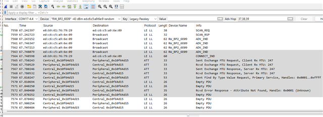

  • OK, I think I figured out how to track connections and whatnot... So what I did here was to track my target instead of the central to see what it's doing.  Looks like it's asking for this 0001 and getting it rejected.  See starting at line 7563.
    So that has me wondering about this whole, how you decide what you're looking after thing...  I'm guessing I have this set up incorrectly some how... What's the sequence of calls with what values to get this looking correctly?
    Also, I'm wanting to lok at a couple of services here.. Should I just add the UUIDs of things I'm looking for?
    Looking at the particular record where it's asking about the UUID, it has the composite UUID correct as far as I can tell unless it needs to be asking in big endian order.
