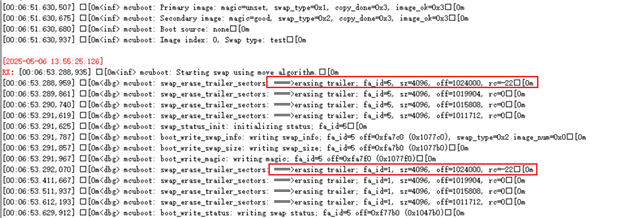

We use nrf54l15dk + MX25R8035F external flash to do the matter development on NCS2.9.0, and we meet some problems:
1. when the matter.ota is 1003KB, takes about 10min30s to get the new fw, and 3min18s to do the swap algorithm, is it a normal speed?
2. The swap algorithm is executed every time the device is powered on, and the swap type is "perm". Following is my log:
    To reduce the swap time, you can set CONFIG_NRF_RRAM_WRITE_BUFFER_SIZE to '=20' in your MCUBoot configuration. This will be the default in the upcoming SDK v3.0.0 release. Regarding the confirm failure, do you have the same partition layout in the new and old version of the app (Partitioning device memory)?
    It also looks like you are using the wrong JDEC ID for MX25R8035F:
    Vidar

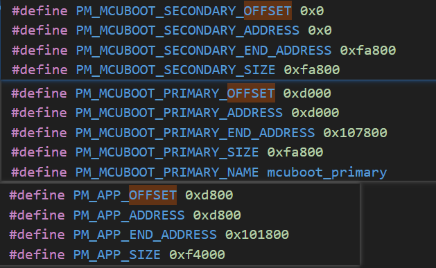

  • here is my pm_static.yml:
    mcuboot:
      address: 0x0
      region: flash_primary
    mcuboot_pad:
      address: 0xD000
    app:
      address: 0xD800
    mcuboot_primary:
      orig_span: &id001
      - mcuboot_pad
      - app
      span: *id001
      address: 0xD000
    mcuboot_primary_app:
      orig_span: &id002
      - app
      span: *id002
      address: 0xD800
    factory_data:
      address: 0x107800
    settings_storage:
      address: 0x108800
    fillter_storage:
      address: 0x112800
    mcuboot_secondary:
      address: 0x0
      orig_span: &id003
      - mcuboot_secondary_pad
      - mcuboot_secondary_app
      region: external_flash
      span: *id003
    mcuboot_secondary_pad:
      address: 0x0
    mcuboot_secondary_app:
      address: 0x800
    external_flash:
      address: 0xFA800
      device: MX25R80
