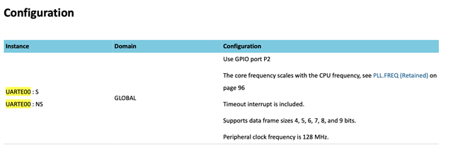

I am currently working with the nrf54l15, I have both the DK and a custom board I designed. I am running into issues with the uart00 peripheral when using custom GPIO pins on Port P2. I have connected the DK up to a logic analyser and I confirmed that when connected to the dedicated uart pins 2.7 and 2.8, everything works as expected. However, when using other pins on port P2 such as 2.4 and 2.5, I cannot get the peripheral to work correctly. Note that I have disabled the flash memory which is connected to spi00 for when testing pins 2.4 and 2.5. I have also tested other pins on Port 2 and haven't been able to replicate the working result with the logic analyser.

I am a quite confused why this is happening since the data sheet states that you can use GPIO on P2 for uarte00.
Have I missed something somewhere?

    Peripherals on P2 can only be used on the dedicated pins.
    UARTE00 can only use P2.00/P2.07 for RX, P2.02/P2.078 for TX, P2.04/P2.09 for CTS and P2.05/P2.10 for RTS.
    See the pin assignments section for a overview of all the dedicated pins on P2.
