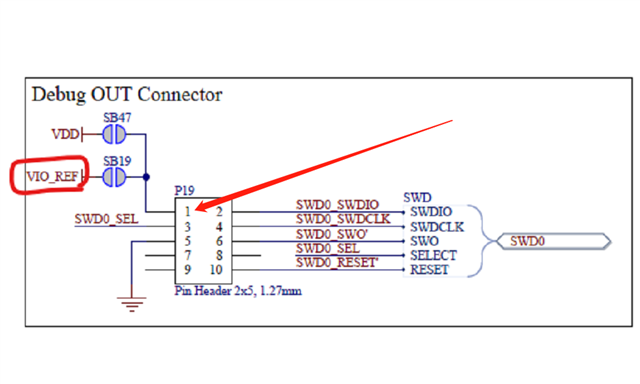

Hi Support Team
Could you specify the maximum driving current of the number 1 pin in the Debug OUT Connector on the nRF5340 DK? Many thanks.

Hi Tom,
Pin 1 of the Debug Out pin is connected to VDD.. It is suggested to keep the supply below 100mA: "To avoid overloading the power supply and damaging the DK, use VDD and keep the supply below 100 mA. Do not use a Lithium-polymer (Li-Poly) source."
