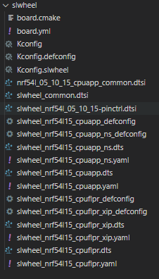

Im currently trying to add FOTA via BLE to my project.
To get familiar with this i wanted to add FOTA as described in the nrf connect intermediate course lesson 5.
So i added FOTA and it worked like a charm using the nrf54l15DK. So i edited the board to be my custom board. Thats wqhere the problems started.
So i thought lets make a new board to eliminate all problems coming with my real custom board.
I followed the instructions in the intermediate course lessong 3 excercise 2 to add my own board.
I used the nrf54l15DK as the base and made all changes described as well as removed the configurations for the soc´s other that the L15.
Currently my board definition looks like this:
To make sure everything works fine i compiled everything using the DK -> That worked.
I changed the Board to be this new board -> now im missing the spi?
The error message displayed is:
c:/ncs/toolchains/b620d30767/opt/zephyr-sdk/arm-zephyr-eabi/bin/../lib/gcc/arm-zephyr-eabi/12.2.0/../../../../arm-zephyr-eabi/bin/ld.bfd.exe: zephyr/drivers/flash/libdrivers__flash.a(spi_nor.c.obj):(.rodata.spi_nor_0_config+0x0): undefined reference to `__device_dts_ord_114'
I made no changes to any dts file other than the ones described in the exercise and removing all mentions of the other soc variants.
Can you help me what my Problem is?
Maybe you can provide a minimal board definition for BLE FOTA?
