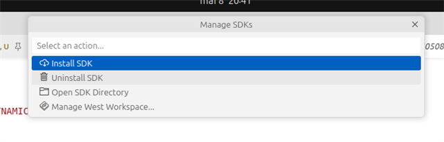

    Looking into the support info, I can see there is a list of paths with the corresponding toolchain/SDK version info.  The XXX directory is no longer present, but I suppose it may have been deleted when I renamed the folder.
    Is there any valid reason for the nrf connect extension to be accessing unrelated folders when working wihtin a different folder?
    Is there a mechanism to clean out old projects from the list of sdks?

    Is this folder still present on your computer after renaming? Does it show in the list  here at all? What content was in that folder?
    Our developers inform me: nRF Connect for VSCode will look at all the registered SDK in the cmake registry and will detect what version and type they are so we can preset all SDK in the SDK selection example when building
  • I'm guessing you have already found a solution to this. For those who haven't, you can cleanup your sdk references from the nrf vs-code plugin by going to Welcome panel > Manage SDKs and click on Uninstall SDK.
    Just click on the problematic entries and you'll get rid of those annoying output logs.
