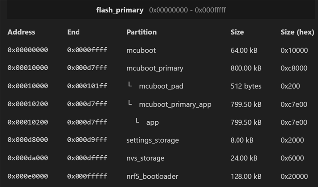

    But if I look the flash partitions, I see always nrf5_bootloader @ 0x000e0000. This is not problem in my current application, but is there some CONFIG option which can be used to remove that partition?
    Or is it only way to use Partition Manager and/or pm_static.yml?
    That is odd, I do not see that. Can you reproduce with a sample and share the partition report? Or where do you see the nrf5_bootloader partition?
    (That said, as long as you don't need all the flash it is not a problem)

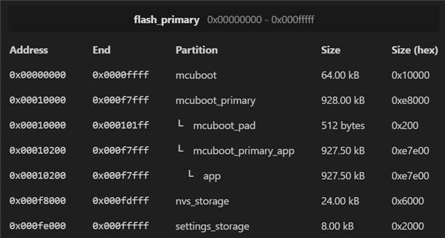

    I tried the BLE peripheral_uart example but the partition layout seems to be reasonable with example. So there must be something wrong in my application.
    Here's my application flash partitions (when
    CONFIG_BOARD_HAS_NRF5_BOOTLOADER=n)
    And here's the normal(?) partition table (based on BLE peripheral_uart example).
    My project has following at sysbuild.cmake
    if(SB_CONFIG_BOARD_NRF52840DONGLE)
      set(PM_STATIC_YML_FILE ${CMAKE_CURRENT_LIST_DIR}/boards/nrf52840dongle_nrf52840_pm_static.yml CACHE INTERNAL "")
    endif()
    The BLE peripheral_uart does not have such file at all.
    My project has boards/nrf52840dongle_nrf52840_pm_static.yml
    nrf5_bootloader:
      address: 0xE0000
      end_address: 0x100000
      placement:
        align:
          start: 0x1000
        before:
        - end
      region: flash_primary
    So is it so that above "boards/nrf52840dongle_nrf52840_pm_static.yml" is reason for this flash partition entry that does not disappear when settings CONFIG_BOARD_HAS_NRF5_BOOTLOADER=n?
    I think above files are added when migrating to SDK v2.9.0 (see nRF52840 dongle, BLE peripheral_uart example, SDK migration from 2.6.0 to 2.9.0 ).
    So when using MCUboot (@0x0), then above pm_static.yml can be cleared/removed and flash partitioning would be correct for non-nrf5-bootloader/mbr?
