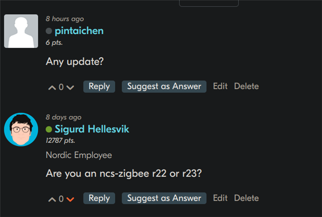

But it compiles with the following error " fatal error: zboss_api.h: No such file or directory".
    Can you post the full build log using the Insert-> Code feature?
    I ask because sometimes there are Override Kconfig Warnings (or other things) earlier in the logs that cause later errors, so it is good to see the full logs.
    Sigurd Hellesvik
    Sorry,I try to add log using Insert->Code,but I don't know why I can't submit it.
  • Ah, that can happen sometimes. In that case, try to upload the log as a .txt file instead.
