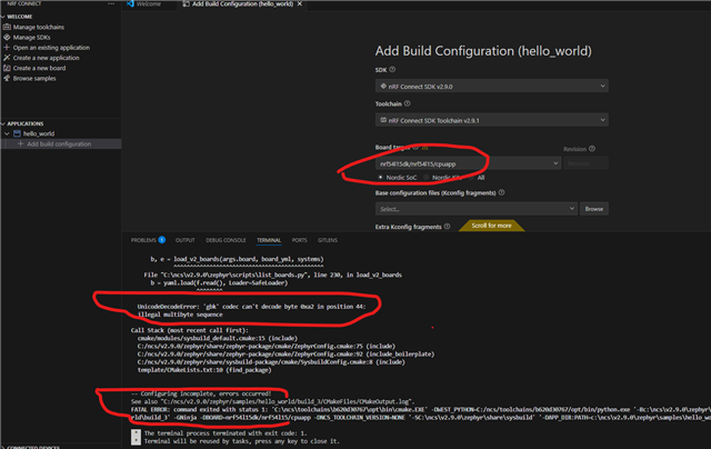

NCS 2.9.0,board type "nrf54L15dk", compile demo "Hello world" report ERROR!
-- Found Python3: C:/ncs/toolchains/b620d30767/opt/bin/python.exe (found suitable version "3.12.4", minimum required is "3.8") found components: Interpreter
-- Cache files will be written to: C:/ncs/v2.9.0/zephyr/.cache
CMake Error at C:/ncs/v2.9.0/zephyr/cmake/modules/boards.cmake:196 (message):
Error finding board: nrf54l15dk
Error message: Traceback (most recent call last):
File "C:\ncs\v2.9.0\zephyr\scripts\list_boards.py", line 469, in <module>
dump_v2_boards(args)
File "C:\ncs\v2.9.0\zephyr\scripts\list_boards.py", line 416, in dump_v2_boards
boards = find_v2_boards(args)
File "C:\ncs\v2.9.0\zephyr\scripts\list_boards.py", line 341, in find_v2_boards
b, e = load_v2_boards(args.board, board_yml, systems)
File "C:\ncs\v2.9.0\zephyr\scripts\list_boards.py", line 230, in load_v2_boards
b = yaml.load(f.read(), Loader=SafeLoader)
UnicodeDecodeError: 'gbk' codec can't decode byte 0xa2 in position 44:
illegal multibyte sequence
cmake/modules/sysbuild_default.cmake:15 (include)
C:/ncs/v2.9.0/zephyr/share/zephyr-package/cmake/ZephyrConfig.cmake:75 (include)
C:/ncs/v2.9.0/zephyr/share/zephyr-package/cmake/ZephyrConfig.cmake:92 (include_boilerplate)
C:/ncs/v2.9.0/zephyr/share/sysbuild-package/cmake/SysbuildConfig.cmake:8 (include)
template/CMakeLists.txt:10 (find_package)
See also "C:/ncs/v2.9.0/zephyr/samples/hello_world/build_3/CMakeFiles/CMakeOutput.log".
FATAL ERROR: command exited with status 1: 'C:\ncs\toolchains\b620d30767\opt\bin\cmake.EXE' -DWEST_PYTHON=C:/ncs/toolchains/b620d30767/opt/bin/python.exe '-Bc:\ncs\v2.9.0\zephyr\samples\hello_world\build_3' -GNinja -DBOARD=nrf54l15dk/nrf54l15/cpuapp -DNCS_TOOLCHAIN_VERSION=NONE '-SC:\ncs\v2.9.0\zephyr\share\sysbuild' '-DAPP_DIR:PATH=c:\ncs\v2.9.0\zephyr\samples\hello_world'
* The terminal process terminated with exit code: 1.
* Terminal will be reused by tasks, press any key to close it.
screen shot as follow:
I download NCS 2.9.0 and want to run a demo on 54L15 dk, this error make me confused,  so what cause this error ? how can I resolve it ?
