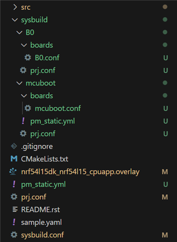

My current directory
Please help me with the enabling both the B0 bootloader and MCUBOOT along with application as project.

  • Hi  ,
    Thanks for your input and I have got a lot of idea from mentioned page.
    I have tried to include the B0 bootloader using SB_CONFIG_SECURE_BOOT_APPCORE=y in susbuild.conf file.
    But I wanted to customize few things and settings in B0 bootloader. But facing build error, not sure why I'm not facing any issue when building with customized configurations.
    Is folder structure given in previous questions image correct to customize both B0 and mcuboot bootloaders?
    Almost, the build system is sensitive for capital letters, so you will have to rename then "b0" instead of "B0". Here's a sample that has a b0 overlay within the sysbuild folder: https://github.com/nrfconnect/sdk-nrf/tree/main/samples/keys/hw_unique_key/sysbuild.
