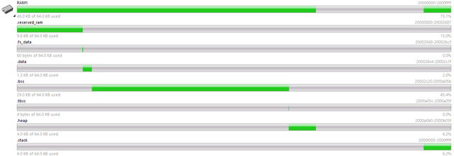

    Currently 48k out of 64k RAM is used when building the project.
    I've attached the RAM breakdown from the build. I'm looking into RAM7 Section 1 which starts at 0x2000F000
    When is this heap initialization to 0xCDCDCDCD happening? It persists through reset so it's not just from the initial build.

  • I managed to see now that RAM is indeed retained but after the call to OS_InitKern(), which is the very first line of code, the RAM is then initialized to 0xCDCDCDCD. I assume then that this is an embOS related issue. We are using embOS-Safe in our project
