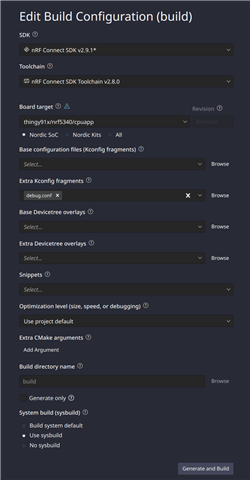

i am currently trying to build a minimal firmware for the nRF5340 on the Thingy:91x.
Unfortunately my build failles to link  zephyr/zephyr_pre0.elf:
FAILED: zephyr/zephyr_pre0.elf zephyr/zephyr_pre0.map .../app/build/app/zephyr/zephyr_pre0.map
: && ccache .../ncs/toolchains/b81a7cd864/opt/zephyr-sdk/arm-zephyr-eabi/bin/arm-zephyr-eabi-gcc -Os -DNDEBUG -gdwarf-4 -gdwarf-4 zephyr/CMakeFiles/zephyr_pre0.dir/misc/empty_file.c.obj -o zephyr/zephyr_pre0.elf  zephyr/CMakeFiles/offsets.dir/./arch/arm/core/offsets/offsets.c.obj  -T  zephyr/linker_zephyr_pre0.cmd  -Wl,-Map=.../app/build/app/zephyr/zephyr_pre0.map  -Wl,--whole-archive  app/libapp.a  zephyr/libzephyr.a  zephyr/arch/common/libarch__common.a  zephyr/arch/arch/arm/core/libarch__arm__core.a  zephyr/arch/arch/arm/core/cortex_m/libarch__arm__core__cortex_m.a  zephyr/arch/arch/arm/core/cortex_m/cmse/libarch__arm__core__cortex_m__cmse.a  zephyr/arch/arch/arm/core/mpu/libarch__arm__core__mpu.a  zephyr/lib/libc/picolibc/liblib__libc__picolibc.a  zephyr/lib/libc/common/liblib__libc__common.a  zephyr/soc/soc/nrf5340/libsoc__nordic.a  zephyr/boards/boards/arm/thingy91x/libbmm350_init_minimal.a  zephyr/subsys/retention/libsubsys__retention.a  zephyr/drivers/usb/device/libdrivers__usb__device.a  zephyr/drivers/usb/common/nrf_usbd_common/libdrivers__usb__common__nrf_usbd_common.a  zephyr/drivers/clock_control/libdrivers__clock_control.a  zephyr/drivers/console/libdrivers__console.a  zephyr/drivers/gpio/libdrivers__gpio.a  zephyr/drivers/hwinfo/libdrivers__hwinfo.a  zephyr/drivers/i2c/libdrivers__i2c.a  zephyr/drivers/mbox/libdrivers__mbox.a  zephyr/drivers/pinctrl/libdrivers__pinctrl.a  zephyr/drivers/regulator/libdrivers__regulator.a  zephyr/drivers/retained_mem/libdrivers__retained_mem.a  zephyr/drivers/serial/libdrivers__serial.a  zephyr/drivers/timer/libdrivers__timer.a  modules/nrf/lib/ram_pwrdn/lib..__nrf__lib__ram_pwrdn.a  modules/nrf/subsys/fw_info/lib..__nrf__subsys__fw_info.a  modules/nrf/drivers/hw_cc3xx/lib..__nrf__drivers__hw_cc3xx.a  modules/hal_nordic/nrfx/libmodules__hal_nordic__nrfx.a  modules/segger/libmodules__segger.a  -Wl,--no-whole-archive  zephyr/kernel/libkernel.a  -L.../app/build/app/zephyr  zephyr/arch/common/libisr_tables.a  -mcpu=cortex-m33  -mthumb  -mabi=aapcs  -mfp16-format=ieee  -mtp=soft  -fuse-ld=bfd  -Wl,--gc-sections  -Wl,--build-id=none  -Wl,--sort-common=descending  -Wl,--sort-section=alignment  -Wl,-u,_OffsetAbsSyms  -Wl,-u,_ConfigAbsSyms  -nostdlib  -static  -Wl,-X  -Wl,-N  -Wl,--orphan-handling=warn  -Wl,-no-pie  -specs=picolibc.specs  -DPICOLIBC_LONG_LONG_PRINTF_SCANF  .../deps/nrfxlib/crypto/nrf_cc312_platform/lib/cortex-m33/soft-float/no-interrupts/libnrf_cc312_platform_0.9.19.a -L".../ncs/toolchains/b81a7cd864/opt/zephyr-sdk/arm-zephyr-eabi/bin/../lib/gcc/arm-zephyr-eabi/12.2.0/thumb/v8-m.main/nofp" -lc -lgcc && cd .../app/build/app/zephyr && .../ncs/toolchains/b81a7cd864/usr/local/bin/cmake -E true
.../ncs/toolchains/b81a7cd864/opt/zephyr-sdk/arm-zephyr-eabi/bin/../lib/gcc/arm-zephyr-eabi/12.2.0/../../../../arm-zephyr-eabi/bin/ld.bfd: zephyr/boards/boards/arm/thingy91x/libbmm350_init_minimal.a(bmm350_init_minimal.c.obj): in function `i2c_reg_write_byte':
.../deps/zephyr/include/zephyr/drivers/i2c.h:1587: undefined reference to `__device_dts_ord_133'
collect2: error: ld returned 1 exit status
My suspicion is that the libbmm350_init_minimal.a library, that is built for the thingy board to reduce the quiescent current of the BMM350, is only build once (only one libbmm350_init_minimal.a file in the build folder) with the devicetree-handle __device_dts_ord_133 (handle for the ldo powering the sensors), but the multi-image-build actually has multiple devicetree_generated.h files for the different images which use different handles:

Does anyone know how to solve this problem?
I am building against the sdk-nrf v2.9.1.

  • Hi Johannes,
    The error you get is because the nPM1300 GPIOS has not been enabled. You need to enable npm1300_gpios. Additionally, the regulators and charger nodes should be inside the pmic_main node in your devicetree overlay. So you need to have this in your overlay:
    &pmic_main {
    	status = "okay";
    	npm1300_gpios {
    		status = "okay";
    	regulators {
    		status = "okay";
    	charger {
    		status = "okay";
    		/delete-property/ charging-enable;
    Marte
