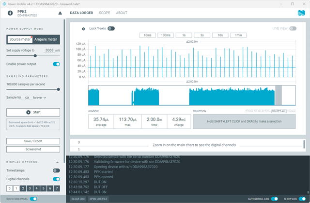

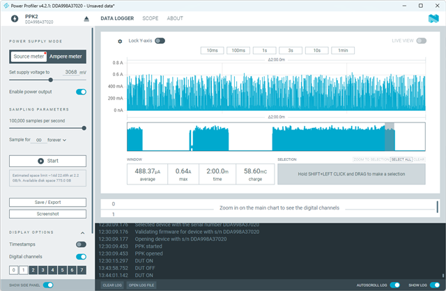

I built a battery powered custom PCBA with the NRF54L15 and the nPM1300. All the configuration and register work via I2C seems to be working properly (reading V_BAT, T_NTC, controlling LED2 and LDSW via host). I'm currently running the PCBA on a PPK2 to evaluate current consumption. On normal run the system takes 700uA when shipmode is grounded (only 50k internal pullup) by wake sensor and 470uA, when wake sensor is not triggering. Not the best results, but for the first shot ok.
When the nPM enters shipmode (via I2C), the current consumption only falls to 35uA (not the expected 350nA). I checked the measurement with the nPM1300-ek, which gave me correct measurement values of about 350nA in ship mode (with some spikes every 2s).

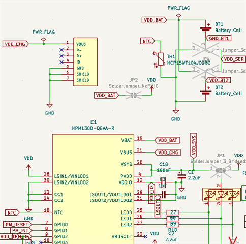

Additionally here's a small cutout from the schematic (don't want to disclose too much details):
The 2 coin-cell batteries (or in this case the PPM2) are only connected to the VBAT (VDD_BAT net in the schematic). No capacitor, resistor or any other componets are connected.
I really cannot figure out, what the issue could be. Am I missing some configuration?

  • Ah, sorry, I didn't tell you that VDD of the nRF54x is connected to VOUT1, which should be cut down in sleep. All components are connected to the VDD. Only the nPM is connected to VBAT.
    Here's the voltages on nPM1300 pins:
    1 (VOUT1): 780mV
    3 (SW1): 780mV
    4 (VSYS): 518mV
    12 (VDDIO): 430mV
    13 (SDA): 430mV
    14 (SCL): 430mV
    17: 0mV
    18 (NTC): 0mV
    19 (VBAT): 3000mV
    20 (VSYS): 510mV
    21 (VDD_CHG): 0mV
    25 (LED): 0mV
    26 (LED): 1400mV eff (some pulsing voltage with capacity)
    27 (LED): 0mV
    others are also 0mV
    I thought, in ship mode, VOUT1 and VDDIO would be 0V? did I miss-configure anything? or are there any recommendations for reaching the 370nA sleep?
