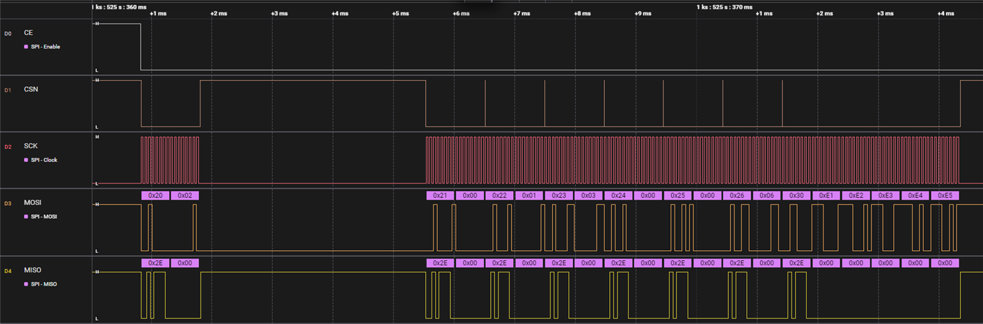

Hello Everyone,
I try to develop Nuvoton + NRF24L01 SPI communicate each other. And I don't understand why MISO bus has 0x0E after I send Write_Command 0x20?

    NRF24_AdressTX(TX_ADDR, TxAddr);
And I send these configurations to MOSI bus as you can see in the picture. Is it correct way?
while(1)
            NRF24_Transmit(0x01);
            delayMS(500);
After configurations datas, I send 0xA0(PAYLOAD) and 0x01(MY DATA). I still get 0x0E, Why MISO Bus return 0x0E every write command?
NOTE: This code works as only transmitter. Not Reciever.
Questions
1) Is it correct way to control NRF24L01? If I am not what is the correct way for it?
2) My SCK Delay is 15us HIGH 15us LOW, is it enough?
3) When I Triggered CE pins HIGH TO LOW, I started to write period and send 1 byte data as well, but Is CE Pin need to be HIGH to finished sending all data? Or CE trigger is okay as you can see at above the picture.
