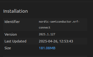

I have an issue with VS code. The connected devices does not show my jlink debugger nor the DK. However, nrf connect desktop programmer shows them.
Toolchain: v2.6.1
SDK : v2.6.1

The issue is fixed now. The nRF connect extension in VS code got auto updated and for some reason the programmer was not detected. I downgraded the extension and now everything is working fine.
