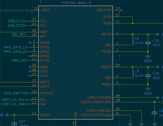

I’m working with a custom board using the nRF54L15 and the latest Nordic SDK, and I’m facing an issue while trying to communicate with an nPM1300 over I2C.
Here’s what I’ve observed:

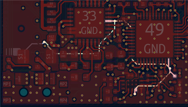

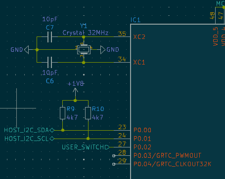

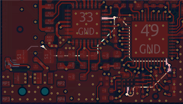

  • On the logic analyzer, I can see that the SDA line is being pulled down, but nothing happens afterward.
  • The SCL line remains high after the SDA is pulled down.
  • I’ve checked the I2C lines and confirmed that neither is shorted, and I have 4.7k pull-up resistors on both lines.
  • To verify the MCU can drive the SCL line, I swapped the pins in the configuration, and the MCU is able to pull SCL low.
I’m getting a -5 error code, which seems to occur at this line in the i2c_nrfx_twim.c file:
ret = k_sem_take(&dev_data->completion_sync, I2C_TRANSFER_TIMEOUT_MSEC);
Any help troubleshooting this or suggestions on what might be causing the issue would be greatly appreciated.
