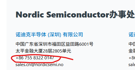

Hi, is it possible to assign a FAE from ShenZhen in China? Then I can contact him/her directly.
And the below landline is always no answers.
