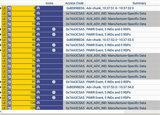

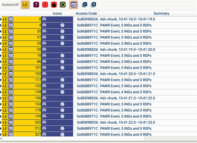

> Could you please point me to where in the sniffer trace I should look at
The trace should show periodic adverts with 5 IND events and 0 responses.
You will note that this is not the case for either the "pd_hardware.pcapng" capture above, or the "5340dk-1800mv.pcapng" capture above.
I include screenshots below with the "good" (regular 3.3v) 5340dk on the left, and the "bad" pd_hardware on the right:
