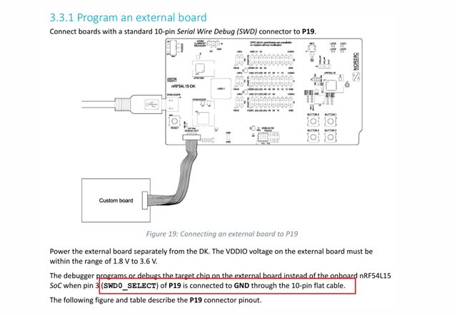

1. It was measured that SWD0_SELECT needs to be connected to VDD to program the external nRF54L15
2. Will the document or the program be modified here to make it consistent with the document description?

1.The problem has been found. There is no issue with connecting this SWD0_SELECT to GND
2. There is a bug that when the external nRF54L15 cannot be detected, VDD SWCLK SWDIO GND SWD0_SELECT needs to be re-plugged and unplugged. However, this is not a wiring issue but a bug in the Jlink software.
