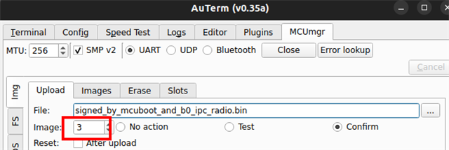

    Following this sample mcuboot_netcore_serial_recovery , it's mentioned to use the signed binary for the network core.
    I've already tested it, and it results in the application not booting.
    The sample assumes that you just need to use a different binary, which I think is not enough.

    Address information about the firmware image is transparent to the mcumgr client and it will only send the raw FW data over the serial interface. You do however need to specify the image number here:
    This tells the server to write the image to the mcuboot_primary_1 slot.

  • Hi Vidar,
    Thanks a lot for pointing out the image number; it works now.
    Also, thanks for sharing the serial recovery guidance page. Although I've checked it several times, I don't know how I missed the index mentioned in the MCUmgr command.

  • Hi
    How did you update both app core and net core at a time in Mcuboot serial recover mode? did you upload them one by one and then reset the device?
    • ./mcumgr image upload <build_dir_path>app_uodate.bin -e -n 3 -c serial_conn
    • ./mcumgr image upload <build_dir_path>net_ypdate.bin -e -n 1 -c serial_conn
    • reset device
      And can you share your mcuboot.config file?
      Thanks
  • Hi
    Yes, you upload them one by one, but for the NET Core image, you need to wait around 30 seconds after the upload to get the NET Core updated before resetting the device.
