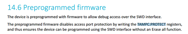

    The chip will by default have access port protection (read back protection) enabled by design.
    So it's only an eraseall operation that can clear the access port protection, when eraseall is executed the access port protection is disabled until next reset.
    It's possible to disable access port protection by programming the chip with firmware that disable it from the inside (e.g. write appropriate values to the UICR and registers in RAM). This is for instance what happens when you program the chip during developing a project or if you execute a recover operation. The recover operation will program a small program in start of code space that disable access port protection.

    Could you kindly provide clarification on the following matters concerning access port protection.
    Is it feasible to access the CPU registers through the Mailbox interface by utilizing the CTRL-AP (Control Access Port)? In other words, can I temporarily disable access port protection by modifying the TAMPC.PROTECT registers via the Mailbox interface?
