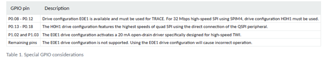

    My first point of investigation is if your sensor requires high speed functionality from the pin. Different drive configurations are available for a subset of the GPIO pins. See the table below, which is a screenshot from the nRF5340 PS - Pin assignments.
    Since you are testing two different sensors, this makes it hard to evaluate if it is P1.06 which is the issue or if the LSM6DSV does not have the same requirements as the LIS2MDL in terms of drive configuration. I recommend starting out with testing a pin which supports high drive configurations.
