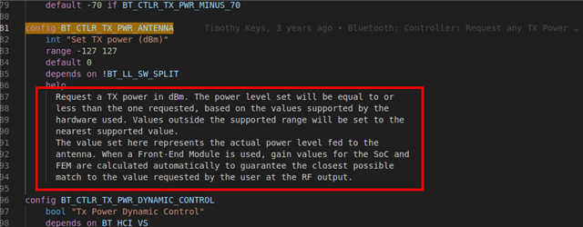

Update / Question 3: I found out that the old board's configuration also compiles successfully with the FEM configuration active in sysbuild/hci_ipc.conf (but no corresponding hardware being defined). Up till now, I used CONFIG_BT_CTLR_TX_PWR_PLUS_3=y to get the maximum tx power on the nRF5340 standalone. Now, with nRF21540, I use CONFIG_BT_CTLR_TX_PWR_ANTENNA=20 instead. According to my research, the software should automatically configure the nRF5340's output tx power to match the defined antenna power. What happens to the nRF5340 standalone (no nRF21540 present) if I use CONFIG_BT_CTLR_TX_PWR_ANTENNA=20 instead of CONFIG_BT_CTLR_TX_PWR_PLUS_3 in this configuration?
    The CONFIG_BT_CTLR_TX_PWR_ANTENNA symbol must be used when using the FEM, but can also used instead of BT_CTRL_TX_PWR_* to request desired output power for boards without FEM enabled.
