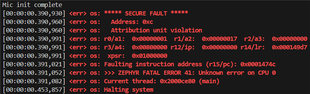

    Well, thinking perhaps using just one pwm-channel might be too much, I tried using two:
    with nrf9161dk_nrf9161_ns.overlay:
    &pinctrl {
        /* PWM0.ch0 → BCLK on P0.21 */
        pwm0_ch0: pwm0_bclk {
            group1 { psels = <NRF_PSEL(PWM_OUT0, 0, 21)>; };
        /* PWM1.ch0 → LRCLK on P0.23 */
        pwm1_lr: pwm1_lr {

    but that won't even start, but returns:
    Mic init complete
    [00:00:00.390,930] <err> os: ***** SECURE FAULT *****
    [00:00:00.390,960] <err> os: Address: 0xc
    [00:00:00.390,960] <err> os: Attribution unit violation
    [00:00:00.390,991] <err> os: r0/a1: 0x00000001 r1/a2: 0x00000017 r2/a3: 0x00000000
    [00:00:00.390,991] <err> os: r3/a4: 0x00800000 r12/ip: 0x00000000 r14/lr: 0x000149d7
    [00:00:00.390,991] <err> os: xpsr: 0x01000000
    [00:00:00.391,021] <err> os: Faulting instruction address (r15/pc): 0x0001474c
    [00:00:00.391,052] <err> os: >>> ZEPHYR FATAL ERROR 41: Unknown error on CPU 0
    [00:00:00.391,082] <err> os: Current thread: 0x2000ce80 (main)
    [00:00:00.453,857] <err> os: Halting system
    Mic init complete

    For the secure fault, I wonder if you are using overlapping peripheral instances, and it is allready used by secure mode firmware (TF-M). But there is no overlap with PWM instances and other peripherals (see Instatiation), so that may not be the case. I see the error happened at 0x2000ce80 (check again if you modifi the firmware). What do you see there with addr2line?
    I'm new to nordic, my project is pretty standard. I just tried to add two different pwm instances, nothing else fancy going on (to my somewhat limited knowledge Wink).
    addr2line outputs:
    C:/ncs/v3.0.0/zephyr/kernel/init.c:54
    ... which tells us:
    struct k_thread z_main_thread;

    The problem was here:
        pwm1_lr: pwm1_lr {
                group1 { psels = <NRF_PSEL(PWM_OUT0, 0 , 25)>; };
    where I for some reason had "pwm_out0, 1, 25".
