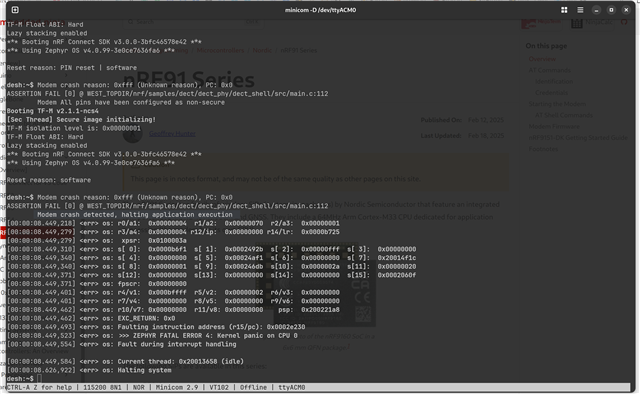

I am trying to run the nRF91x1: DECT NR+ Shell example on my nRF9161 SDK board.
I get this crash when the code runs
Can you point me to the explanation of what I am doing wrong here please
Thanks
Thanks
In order to run the DEC NR+ Shell the nRF9151 must be loaded with the DECT NR+ firmware instead of the Cellular Radio Modem Firmware. The DECT NR+ firmware is available thru you Nordic Semiconductor sales representive.
