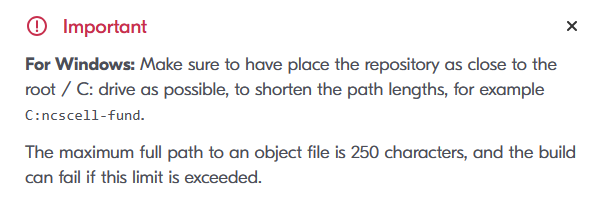

  • Dear Hakon,
    I am using a Mac and have made sure the file path is less than 250 characters.
    I do not see the file: nrf_modem.h in the folder itself. Hence, wondering if you can try to compile the cellular lesson2_exercise2 and let me know if that works for you. Here's the compile error I am getting while building this exercise:
    /opt/nordic/ncs/v2.9.0/nrf/include/modem/nrf_modem_lib.h:10:10: fatal error: nrf_modem.h: No such file or directory
    10 | #include <nrf_modem.h>
    Yes, I already did it using v2.9.0. No error. But I used Windows, not Mac. I don't have a Mac to test with at the moment, but I doubt it is OS related. Maybe you can try to remove and reinstall v2.9.0, and remember to do west update after.
