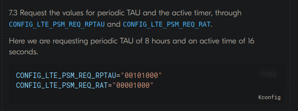

  • The Azure IoT sample has a 10 min interval. How do I set the PSM and DRX interval to 30sec?
  • See this DevAcademy lesson on how to configure these:
    The lesson before that should explain how to set these numbers I believe.
