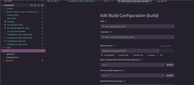

Now when trying to build again I get:
 *  Executing task: nRF Connect: Build [pristine]: testproject/build (active)
Building template
west build --build-dir /NordicTests/testproject/build /home/user/ncs/v2.9.0/zephyr/share/sysbuild/template --pristine --board ZanaBoard_Valve/nrf52833 -- -DNCS_TOOLCHAIN_VERSION=NONE -DBOARD_ROOT=/NordicTests/testproject

  • Ah yes, I do remember this when moving to v2.7. We used the conversion script and have been running v2.7 for many months successfully on hundreds of pieces of hardware. We've also been running v2.9 for a month or so on dozens of hardware as well. The issue is just coming up when trying to edit the configuration and memory layout for the product
    Did the Zephyr provided conversions script not actually migrate this correctly? I see no mention of a CMakeLists file nor a *INIT_PRIORITY* macro in the script.
    The CMakeLists is listed as optional in the documentation you linked and <board>_INIT_PRIORITY is not mentioned at all.
