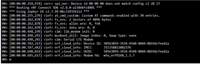

    Then NRF52840 sending at comments but no reply from nrf9160
    output from rtt viewer
    System starting...
    00> UART initialized
    00>
    00> Sent: AT
    00>
    00> Sent: AT+CFUN=1
    00>
    00> Sent: AT+CGMR
