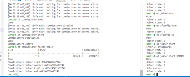

When I simply flash the CLI sample into 2 devices, commissioning works via the command line inputs:
  • Start device A with new dataset, wait until it is leader, then start commissioner and add joiner (wildcard) with PSKd J01NME
  • Start device B, factory reset, ot ifconfig up, ot joiner start J01NME
  • Then the join is successful and I get the command line outputs.

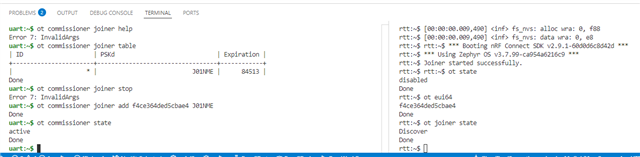

However, using my current program approach:
  • Flash CLI sample into device A, start it as usual, start as commissioner (same as the CLI approach)

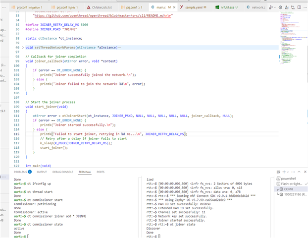

  • Flash a modified CLI sample code (shown below, implemented callback and start_joiner) onto device B
  • Check commissioner state of device A, verify that it is active
  • ot factoryreset on device B to reboot it, and it should start joiner with the defined PSKd.
  • No further logs are displayed, after time limit reaches for commissioner, it will output Commissioner: Joiner remove.
The logs and implementation of start_joiner and joiner_callback are shown below, the left terminal is the commissioner, and the right terminal is the joiner.
How could it be that the joiner_callback was never called? The joiner is also stuck in the Discover state forever, even after the commissioner has expired. No errors were given.

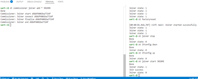

  • Hi Maria,
    I still haven't found a solution to the problem, but I would like you to know that we can also perform the following:
    1. start the commissioner, add wildcard joiner
    2. factoryreset the joiner device
    3. `ot stop joiner` on joiner device
    4. `ot ifconfig down` on joiner device
    5. `ot ifconfig up` on joiner device
    6. `ot joiner start J01NME` on joiner device
    Then the join can still be successful, and everything works out, and the success logs are displayed on the commissioner, as shown below:

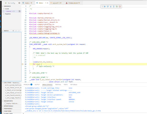

  • I ran the debugger on the Joiner program, but it seems like it halts due to reason 3. However, the command line seems to be active, always. Thus, I don't think I have observed a fatal halt.

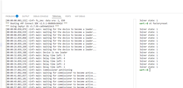

    I still haven't figured out a solution to this issue. By looking at my code and procedures, do you think it SHOULD "just work out" normally? I believe this is quite a simple program that should be straight forward to create.
    Another strange thing that I have noticed recently is that when I run the debugger on my code, it lands at a fatal halt with reason 3. Is this expected behaviour? What does reason 3 mean in this context? I don't think this is something that affects the execution of my program though, as all of my programs run into this issue, but most of them execute without any problems.
    Also, I tried implementing a commissioner by program as well, but it seems like it gets stuck at the petitioning state, similar to how the joiner gets stuck at the discover state.
    I made sure that the commissioner device would become the leader before starting commissioner as well.
    Here are some logs that the 2 programs produced:
    As you see, it is quite unusual, as the commissioner should petition for less than a second before it becomes active (given that it is the leader already), and the joiner should also return some kind of error and return to Idle mode, if it doesn't find a corresponding commissioner within the set time.
    Here are the logs when I manually interact with them, stopping their commissioner/joiner and restarting them by command line:
    The join is successful.
    I'll look out for this as well. Are you building with debugging optimizations before running the debugging session?
    I tried to search for a short time for an explanation on what reason 3 is, but I did not find it. I will search some more and possibly ask one of my colleagues if they know.

  • Hi Allan,
    I did a sniffer trace today, and noticed that the joiner device does not send a Discovery Request when otJoinerStart is called. I have not found out why this is yet, but this is where I'm at now.
    The commissioner was set up before starting the captures, and I have one capture where the joiner is started from CLI and one from the application. The network key is the standard (00112233445566778899aabbccddeeff).
    344777_joiner_start_cli.pcapng344777_joiner_start_app.pcapng

  • Hi Maria,
    Sorry, I forgot to get back to you yesterday.
    I had trouble setting up the sniffer, but I found a piece of sample code that provided a solution to my problem:
    https://github.com/martelmy/NCS_examples/blob/main/openthread/joiner/src/main.c
    openthread_api_mutex_lock(context) and an unlock need to be wrapped around OpenThread API function calls.
    I believe this is good enough for me to start my integration and fix the overall structure of my codebase.
