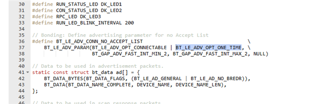

BLE stops advertising after a connection, even with CONFIG_BT_MAX_CONN=6
It seems BLE stops advertising after the first connection. Is this expected behavior? Should I restart advertising in my "connected" connection callback?

// Bonding: Define advertising parameter for no Accept List
#define BT_LE_ADV_CONN_NO_ACCEPT_LIST                                   \
    BT_LE_ADV_PARAM(BT_LE_ADV_OPT_CONNECTABLE | BT_LE_ADV_OPT_ONE_TIME, \
                    BT_GAP_ADV_FAST_INT_MIN_2, BT_GAP_ADV_FAST_INT_MAX_2, NULL)

void bt_advertise(struct k_work* work)
    int err = 0;
    // int err = bt_le_filter_accept_list_clear();
    LOG_INF("BLE: Advertising\n");
    err = bt_le_adv_start(BT_LE_ADV_CONN_NO_ACCEPT_LIST, ad, ARRAY_SIZE(ad), sd,
        ARRAY_SIZE(sd));
    if (err)
        LOG_ERR("BLE: Advertising failed to start (err %d)\n", err);
        return;
K_WORK_DEFINE(bt_advertise_work, bt_advertise);
