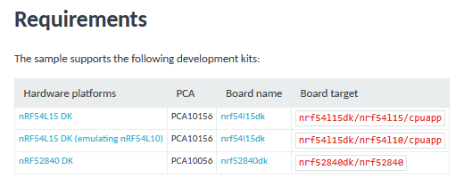

    3. Minimum configuration
    The build failed for nrf54l15dk/nrf54l15/cpuapp/ns.
    The RAM region is overflowing.
    What is the minimum configuration to guarantee the DFU Distributor?
    The DFU Distributor sample does not support the nrf54l15dk/nrf54l15/cpuapp/ns build target, but it does support the nrf54l15dk/nrf54l15/cpuapp build target. See the memory report in the build log for details on how much memory is left after building.
    Yes, I understand that this sample doesn't support NS Build.
    My understanding is that this sample sets Kconfig values with some intention.
    I think I can change some Kconfig values while checking the memory report.
    However, I cannot determine if those values will guarantee the DFU Distributor.
    Therefore, I want to know the minimum configuration for this sample.
