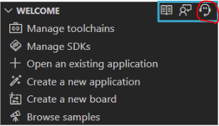

    Could you run "nrfutil self-upgrade" and "nrfutil upgrade", and then try again?
    If it doesn't help, please generate the support information by the top right of the Welcome view and upload the support information via toolbar -> Insert -> file.
    Also, provide the return after running "nrfutil list".

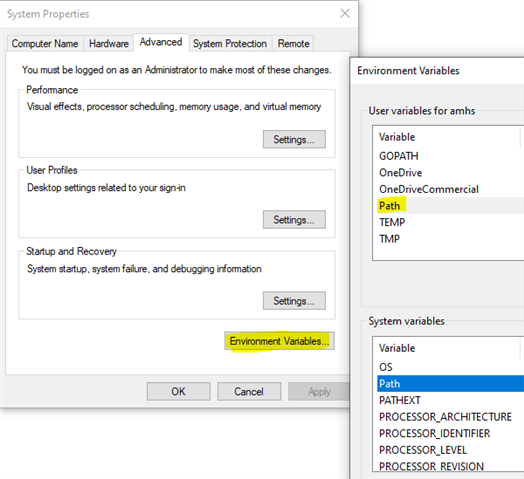

  • Thomas said:
    "C:\\Users\\ThomasMaltesen\\AppData\\Local\\Packages\\PythonSoftwareFoundation.Python.3.7_qbz5n2kfra8p0\\LocalCache\\local-packages\\Python37\\Scripts\\nrfutil.exe"
    nrfutil.exe 6.1 under python37 is the very very old nrfutil, which has nothing to do with today's nrfutil. This breaks flashing and debugging since NCS started to use nrfutil for the runners. Please remove it.
    Also, remove the underlined paths as the following figure showing. They are added by the user in the environment variable.
